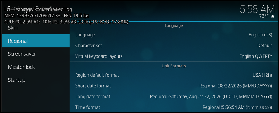

    as I already mentioned. In your configuration, connmand adjust a second time, that is wrong. Should only happen once from: 2026-07-23 (libc release -> start date) to today.
    Jul 23 13:07:11.767278 LibreELEC connmand[516]: Setting domainname to NewfieNet.home
    Jul 23 13:07:11.801306 LibreELEC connmand[516]: eth0 {add} address 10.0.0.82/24 label eth0 family 2
    Jul 23 13:07:11.802613 LibreELEC connmand[516]: Skipping server 10.0.0.1 KoD code RATE
    Jul 23 13:07:11.876947 LibreELEC connmand[516]: ntp: adjust (jump): +1285421.214827 sec
    You will drift away an additional day into the future with every additional day calculated from libc start to today, because it's adjusted a second time with the same delta:
    Aug 07 10:10:53.092100 LibreELEC connmand[516]: ntp: adjust (jump): +1285421.214957 sec
    My router provides also a local NTP and it works fine with LE, so it appears an issue triggered by your specific configuration. The resulting behaviour of connmand appears strange to me, but the following line could be the cause:
    Your pfSense is rejecting the NTP client requests because they are occurring too frequently. You should disable or adjust the "Kiss-of-Death" settings in the pfSense configuration and try again.

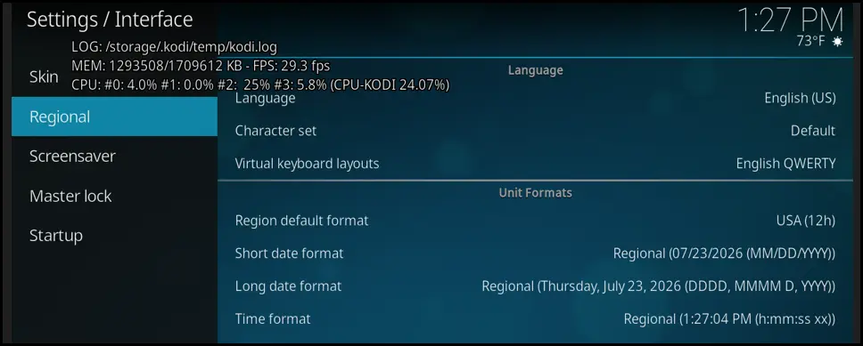

    Repro rPi4 is clean, AUG 5 build. All I did was boot it, finish the wizard (including set of my local TZ) and then I used the LE add-on to turn off the wi-fi (network is hard wired). That's it. Whatever the defaults are, that's what I was using (looks to be DHCP yes).
    Yes, I have NTP services enabled on my network via pfSense.
    I think you nailed both nailed it chewitt and HarryH: the NTP server settings in pfSense did indeed have KOD enabled (for some bloody reason; I swear that was off before). I disabled that, rebooted *everything* and now both rPis running the AUG 5 LE are showing the right time inside KODI when they boot up. Every time! Wonderful!!
