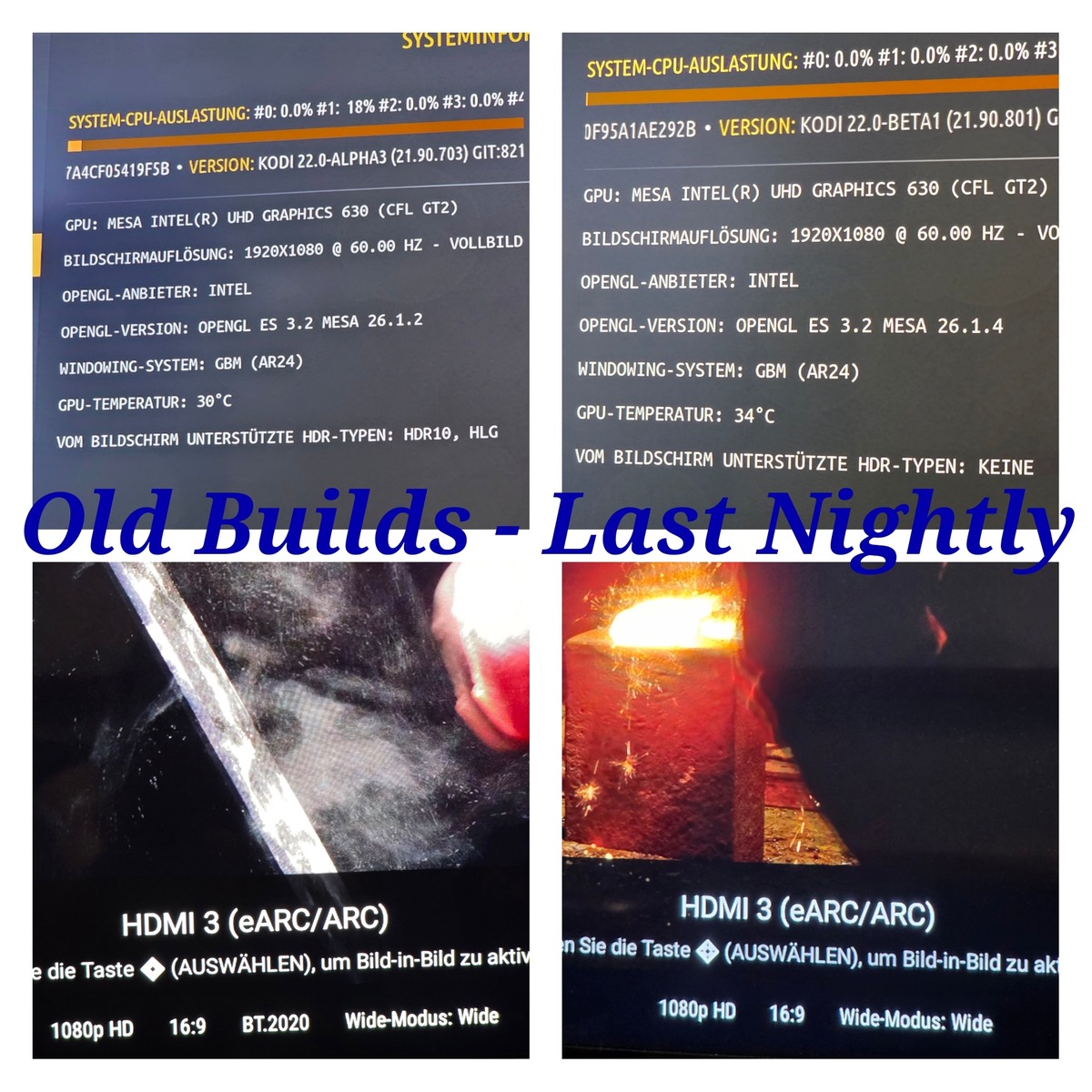

  • After some tested movies I noticed:
    "Adjust display HDR mode" disabled: really nice picture. For my eyes perfect colors and highlights. Brightness 50/50 looks even better.
    "Adjust display HDR mode" enabled: washed out colors, but only with HDR content I believe.
    The tested SDR movies look normal in both modes.
    After all, a big step forward! If nothing more can be done, I would stay with this setup :thumbup:

  • Hey HiassofT and thanks for watching this case too.
    I'm some kind of weird. Does your post explain why the picture looks better with smp s build? Or was it really only imagination? Like mentioned, only if i disable "Adjust display HDR mode" wich not exists in default builds. Enabled looks washed out.
    And does it explain, why my old Sony XH9505 tags the running HDR movies with BT.2020 and SDR movies never (with default libreelec)?
    If it's helpful, I would flash the normal nightly and test again some movies:!:
    The Samsung TV is only a few days old. Maybe I had better testet some image settings before posting here. I only was confused, why the Samsung did not see HDR and the Sony happy switched to what he called BT.2020 and pumps light and colors up.
    Now, with the smp build I had the feeling lights are brighter and colors more vibrant and fiddled again with more brightness, more max brightness and darker BT.1886 setting (-1). Maybe all was imagination and the same settings on a default build would look the same?
    Don't wanted to make so many people so much work. :-/
  • sebden no worries, you seem to have uncovered and interesting bug that likely existed for a long time but no-one noticed so far - and your logs and info were very helpful!
    Better go back to official nightlies, the washed-out colors are with HDR enabled are expected as your gen9 intel can't transmit the HDR infoframe.
    With HDR disabled (so kodi tonemaps HDR->SDR) the output should be identical in nightlies and smp's build.
    But signalling BT2020 for a HDR->SDR tonemapped image is still wrong, so the colors won't be correct, maybe oversaturated (likely both on your Sony and Samsung TVs) - that's something that needs to be fixed in kodi.
    While BT2020 colorspace with SDR gamma would be technically possible it's not a standard combination and it's hard to tell how TVs react to that - especially when the TV doesn't receive a HDR infoframe which would explicitly tell it the used EOTF - that's a bit of undefined territory.
    Your Sony seems to have received the (incorrect) BT2020 colorspace info correctly and shown "BT2020" to you and likely intepreted the BT709 data as BT2020. Not sure which EOTF it used, but if it had used PQ you'd likely have gotten over-bright white and in general a way to high contrast.
    Not sure about the Samsung, maybe it just didn't show you the BT2020 (or it's buried somewhere in deeper info pages).
    Nevertheless, if your PC didn't transmit the HDR infoframe and indicate PQ (or HLG) EOTF it's correct that the TV doesn't show "HDR".
