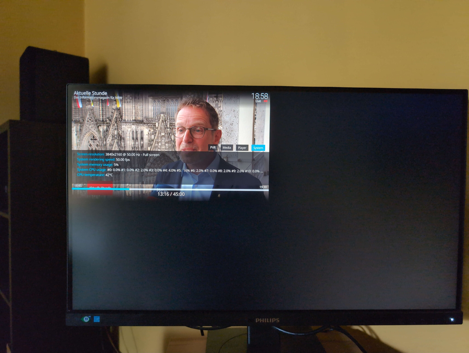

    now Adjust Refresh and 3840x2160@50 causes trouble here:
    movies from SAT-TV (1280@720@50) are displayed as the following:
    the screen is quartered and the TV movie is running only in the upper left quarter with an complete picture
    (o-key tells 3840x2160@50).
    All other quarters are just black.

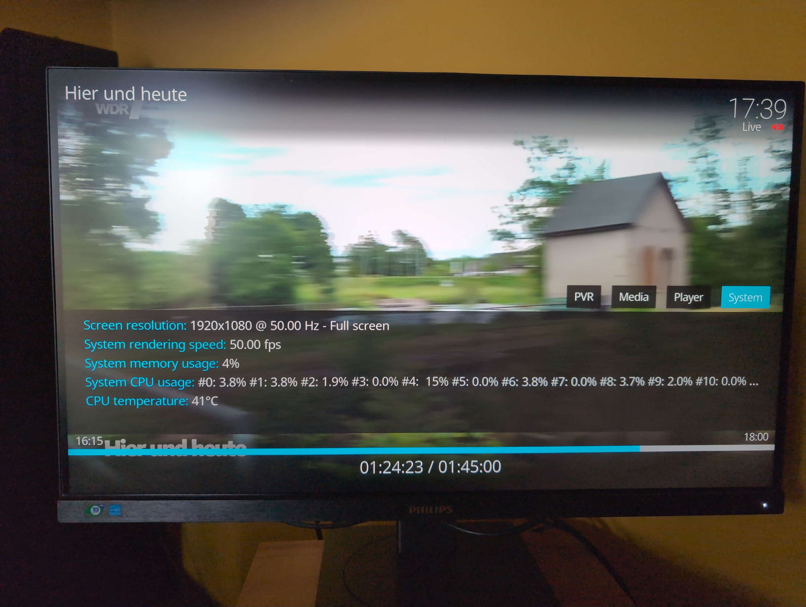

    to get sat-tv upscaled to 4K I need to remove the boot parameter AND
    either "adjust refresh rate on start/stop" set to off OR remove whilelist 3840@50
    otherwise I have a quartered display where o-key tells 3840@50 ! (see attachment !)
    I get the same effect when I set GUI to 50 Hz, although the monitor could do 3840x2160@50

    Clearly displayed in the photo in comment #10: in an quarter of an 4K monitor it says this quarter *is* 4K ...
