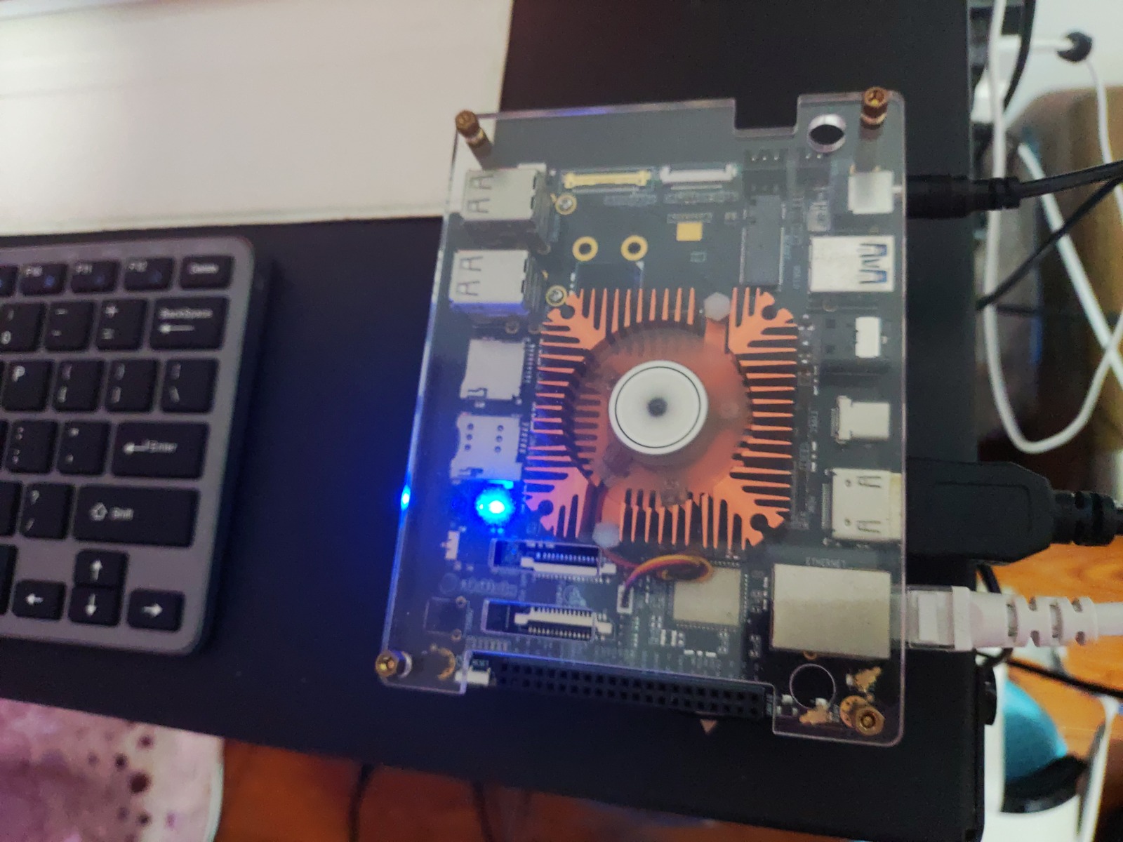

  • Hey, I'm having trouble porting it. I've spent over a month compiling it, and the firmware I finally got only shows the logo briefly on startup before the screen goes black. My development board is a Firefly RK3399. Could you try using that model for me?
  • I've pushed a revised kernel here: https://github.com/chewitt/linux/commits/rockchip-7.2.y which is being used in my current dev branch for RK devices: https://github.com/chewitt/LibreELEC.tv/commits/rockchip - this contains the current patches Kwiboo has been submitting to the mailing lists. I don't have working RK3399 hardware to test with. If you want to eliminate my guesswork you should use this branch https://github.com/Kwiboo/linux-r…803-rk-hdmi-v6/ for the kernel.
  • Thanks for the confirmation. Can I ask you to share some Kodi debug logs of an assortment of different media types and refresh rates. Just to see what's going on underneath.
  • Yes. Let me know which logs you want to see. Just for clarity, I didn't do full test with various media and display options. I've just checked audio output, display output and playing one video file.
