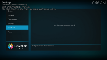

20170621 build for rpi appears to have broken bluetooth. Libreelec is showing no adapter found. Nothing appears in logs.
Rolling back to 20170615 and bluetooth is fine.
No logs no problem.
No logs no problem.
Fresh install and problem persists.
The logs really aren't giving any information. (That I can see.)
Have tried this on 2 RPi's now.

I'm not sure what you mean by "Logfiles" share, however here is the output from the journal when restarting bluetooth.
CodeJun 23 01:45:28 LibreELEC systemd[1]: Stopped Bluetooth service. Jun 23 01:45:28 LibreELEC systemd[1]: Started Bluetooth service. Jun 23 01:45:28 LibreELEC bluetoothd[893]: Bluetooth daemon 5.44 Jun 23 01:45:28 LibreELEC bluetoothd[893]: Starting SDP server Jun 23 01:45:28 LibreELEC bluetoothd[893]: kernel lacks bnep-protocol support Jun 23 01:45:28 LibreELEC bluetoothd[893]: System does not support network plugin Jun 23 01:45:28 LibreELEC bluetoothd[893]: Bluetooth management interface 1.14 initializedHopefully this is okay? Looks like a problem with the kernel bump to .6?

BNEP is not needed and has never been included with RPi builds official or otherwise. There is 0 difference in kernel configuration from my previous release. Not excluding the kernel as a possible cause but it seems strange as it's a minor release.
You have a RPi or RPi2? In that case you have an external bluetooth adapter? Always provide full details about your hardware and full logs.

Apologies, I didn't realise Kodi logging enabled system logging in Libreelec.
RPi3 and only using the internal adaptor.

i had the same problem with my rpi3 internal bluetooth adapter and LibreELEC-RPi2.arm-8.0-devel-20170621. LibreELEC-RPi2.arm-8.0-devel-20170615 is working fine for me, too. I get the same information that no bluetooth controller can be found by kodi.

Just tried 20170626 and still have no bluetooth adapter unfortunately.
As far as I can see from the logs posted earlier, bluetooth is working fine. There's this however:
Code01_KODI.log:00:38:31.574 T:1741681568 ERROR: ## LibreELEC Addon ## bluetooth::monitor::remove_agent ## ERROR: (AttributeError("'NoneType' object has no attribute 'remove_from_connection'",)) 01_KODI.log: File "/home/trondah/LibreELEC.tv/build.LibreELEC-RPi2.arm-8.0-devel/LibreELEC-settings-6336f1e/.install_pkg/usr/share/kodi/addons/service.libreelec.settings/resources/lib/modules/bluetooth.py", line 736, in remove_agentThe only other relevant commit is perhaps upgraded busybox, a new build 20170627 will be uploaded in a moment. Before upgrading, could you just test "bluetoothctl" from the command line and post the output?
