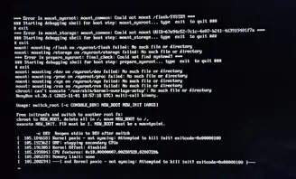

  • Sometimes after restarting or turning on the RPi5 I get this message:
    *** Error in mount_flash: mount_common: Could not mount UUID=0111-4635 ***
    ### Starting debugging shell for boot step: mount_flash… type exit to quit ###
    I've had the RPi5 for a week, and the SD card is also new. It was a fresh LibreELEC installation, and then I restored a backup from the RPi4. It worked fine for a few days until yesterday.
    This is what it looks like after I typed exit several times:
    I tried another SD card (an old 16GB SanDisk) and so far I don't have this error. It was a fresh install and a backup from the problematic SD card (a 64GB Kingston Canvas Go! Plus).
    LibreELEC 12.2.1, RPi5 4GB
    Edited 4 times, last by drrak (November 10, 2025 at 6:40 PM).
