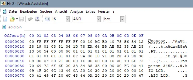

    now i have the edid.bin file.
    i want to change 1920x1080@60hz to 1920x1080@50hz.
    how do i do this?

  • Yeah, now im at the point where i use the edid of my samsung tv with the integrated panel of a wyse aio thin client.
    i only use the 50 and 60 hz settings (there are more like 24hz, 25hz, 48, etc).
    it was just an experiment but it works!
