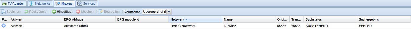

  • Hello,
    The wintv dual seems to be there, but if i try to add muxes, it doesn't work. (DVB-C, Germany, "Privatkabelanlage")
    Everything was ok before with the former LE Version.
    what could be the reason?`
    thank you,
    stefan
    P.S.: I also tried it with a Pi5, but only got the same result.
    Edited 2 times, last by stefan327 (August 17, 2025 at 4:45 PM).
  • I got this when trying to debug:
    2025-08-17 18:06:12.492 [ INFO]:mpegts: 306MHz in DVB-C Netzwerk (0x55b21c3540) - deleting
    2025-08-17 18:06:12.492 [ DEBUG]:mpegts: removing mux 306MHz in DVB-C Netzwerk from scan queue
    2025-08-17 18:06:37.174 [ TRACE]:mpegts: 306MHz in DVB-C Netzwerk - created
    2025-08-17 18:06:37.174 [ DEBUG]:mpegts: adding mux 306MHz in DVB-C Netzwerk to scan queue weight 5 flags 1000
    2025-08-17 18:06:47.173 [ DEBUG]:mpegts: 306MHz in DVB-C Netzwerk - add raw service
    2025-08-17 18:06:47.173 [ DEBUG]:service: 6: 306MHz in DVB-C Netzwerk si 0x7f8c004f80 Silicon Labs Si2168 #0 : DVB-C #0 weight 0 prio 10 error 0 (OK)
    2025-08-17 18:06:47.173 [ DEBUG]:service: 4: 306MHz in DVB-C Netzwerk si 0x7f8c004ec0 Silicon Labs Si2168 #1 : DVB-C #0 weight 0 prio 10 error 0 (OK)
    2025-08-17 18:06:47.173 [ TRACE]:service: will start new instance 4
    2025-08-17 18:06:47.173 [ TRACE]:service: starting 306MHz in DVB-C Netzwerk
    2025-08-17 18:06:47.173 [ INFO]:mpegts: 306MHz in DVB-C Netzwerk - tuning on Silicon Labs Si2168 #1 : DVB-C #0
    2025-08-17 18:06:47.174 [ ERROR]:linuxdvb: Silicon Labs Si2168 #1 : DVB-C #0 - failed to tune [e=Invalid argument]
    2025-08-17 18:06:47.174 [ TRACE]:service: tuning failed
