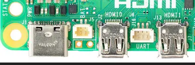

  • Okay, good to know. I'm no expert, I just used the descriptions from the board itself:
    So the HDMI-A-1 is the HDMI0 port on board ?

    You should make sure that you use the HDMI port that is closest to the USB-C port. Then CEC will work again. 12.0.1 temporarily supported CEC on both ports, but there were too many unresolved issues, so support was limited to the first HDMI port.
  • CEC is working on v12.0.1 but stops working on v12.0.2 for whatever reason
