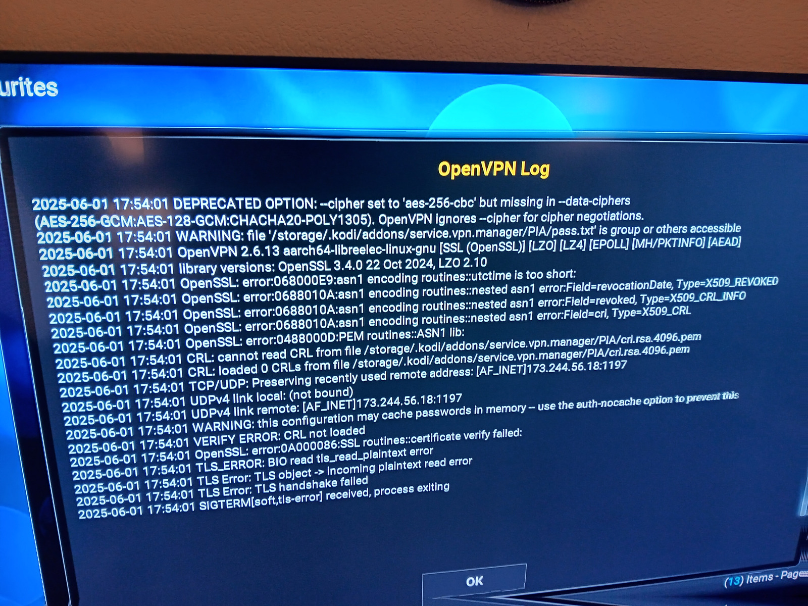

Not sure what's going on here so I defer to the LE Gurus. Just started today. This is a photo of the error log. Running RPi5 with nightly 13.0 20250201.

The OpenVPN config PIA distributes implements a Certificate Revocation List (CRL) check for security reasons, but the CRL data they embed in the config contains invalid dates and this causes connection failures with OpenSSL 3.3.0 or newer. Our master branch (LE13) bumped to 3.3.0 in April 2024 and is currently on 3.5.0, while the LE12 branch is currently on 3.2.4 - so I would assume you have moved from LE12 to LE13 and this introduced the issue.
See https://github.com/openssl/openssl/discussions/24301 - according to posts/reddit threads linked from that discussion thread the workaround is removing the <crl-verify> section from the PIA config.
So if I understand this issue correctly would a clean install of LE13 with OpenSSL 3.5.0 solve this?
If the problem starts with OpenSSL 3.3.0 "and newer" and LE13 is running OpenSSL 3.5.0 .. then no.
Just edit the config and remove the offending <crl-verify> section.

Per your photo of error log location of file is /storage/.kodi/addons/service.vpn.manager/PIA
Need to ssh into unit with putty or winscp from win11 pc.
