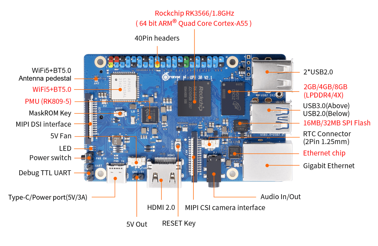

    Could someone create an image for this board for me? I've been using it for a while, just in case something comes out for it.

  • By mainline linux device tree, Orange Pi 3B has 2 HW revisions V1.1 and V2.1.
    I met the ethernet problem on my V2.1 revision device when V1.1 dtb file was used.
    But, it was able to use the ethernet when V2.1 dtb file is used.
    Please check your HW revision and your dtb file I hope.
    HW revision is printed in board.
