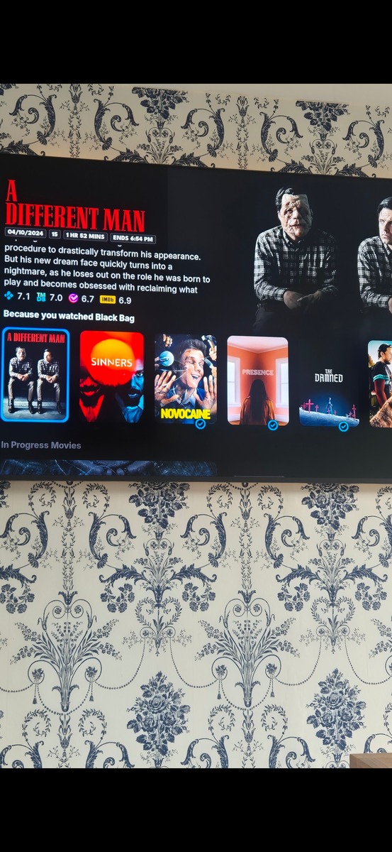

    I have recently installed rpi5 nightly, and i use Arctic Fuse 2 as a skin.
    I have report this issue to jurial.
    Background Style--- Real Blur · Issue #737 · jurialmunkey/skin.arctic.fuse.2
    Skin section Widgets Current Behavior Hi J, long time buddy, and kudos on tmdbh and speed increase. Fabulous. NOW FULL DISCLOSURE. I am playing with Nightlies…
    github.com
    But if you look on images and video there seems to be a clear divide between the fanart image and then the Blur.....
    Imgur
    Discover the magic of the internet at Imgur, a community powered entertainment destination. Lift your spirits with funny jokes, trending memes, entertaining…
    imgur.com
    Apologies of this is not sufficient enough, but let me know whatever more you need.
  • Looks like a skin thing. Even if it’s not and it’s something related to UI rendering on RPi, it’s still best addressed by Kodi who implements the shaders, or skin devs; it’s very unlikely to be LE specific.
    Thank You, i will go back to jurial, and if need be report it to Kodi on their Github.
    Is there anything i can do to help determine if it is LE specific?
    Thanks for prompt response.
  • Run a recent Kodi nightly version on RaspberryPi OS on a spare SD card with the same skin. If you see the same issue (which you should) it's nothing to do with LE.
    Yes, I have tried with other nightlies and is exactly the same.
    Going back to to stable *k21) no issues.
  • Not LE nightlies, Kodi (on Debian/RaspiOS) nightlies.
    Yes, apologies as always, I noticed what you meant after I replied.
    I won't lie, I am struggling in knowing how to install nightly on pi5 as the kodi wiki only gives info to apt install for the current kodi, not nightly.
