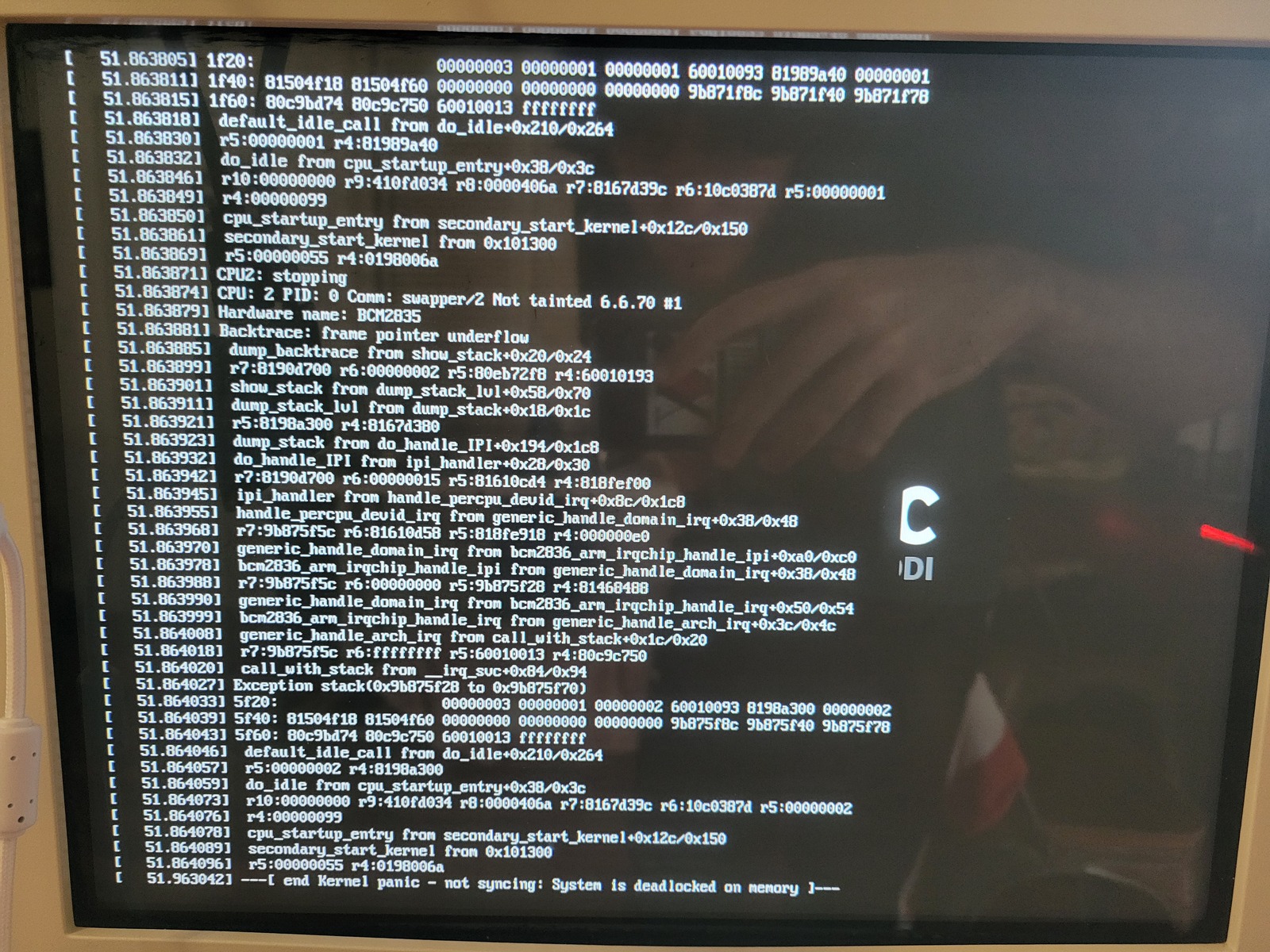

  • Forgive me, as I am very new to this. But I have followed the instructions/videos on this to a tee and cannot get it to work.
    I have a Raspberry Pi 3A, a microSD, and the LibreELEC SD Creator.
    I tried writing the 12.0.2 OS to the SD card right out of the box. It finished, I placed the sd card into the pi3, plugged in the power, and it started booting. I got the LibreELEC logo, something about partitioning files, then the logo flashes and I get a huge wall of error messages.
    I thought maybe the size of the SD card might be the problem, since it's 256gb it is originally exFAT. So I also tried formatting it as FAT32, THEN writing the OS image. No luck either. I then used Disk Manager to wipe the SD card completely, leaving at as a big unallocated partition, then writing the OS. That didn't work either.
    I'm on Windows, and I don't know anything about Linux or Raspberry Pi, so please explain it to me like I'm a moron lol.
