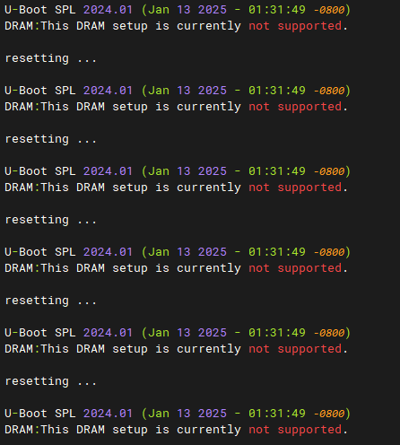

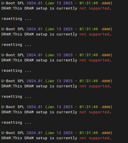

The error message is quite clear, no?

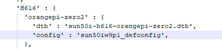

This means that you didn't select correct U-Boot config. U-Boot has to be configured for each board separately, due to different settings, like DRAM (as you already experienced). Board configuration is done here: https://github.com/LibreELEC/Libr…ts/uboot_helper

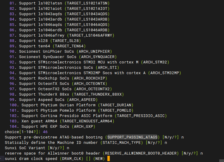

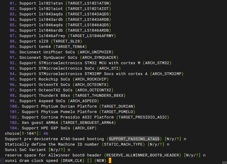

you have to provide DRAM settings, which you can get in Android DT file from vendor image.
Cannot BSP U-Boot be used? Does it mean I need to replace the U-boot or just modify the DRAM.
No, only mainline U-Boot is supported (currently 2025.1.) If your board is already supported, great, all you need to do is to set correct config name in uboot_helper script. If not, you have to create patch for U-Boot, which introduces correct defconfig for your board and then put it in uboot_helper script.
