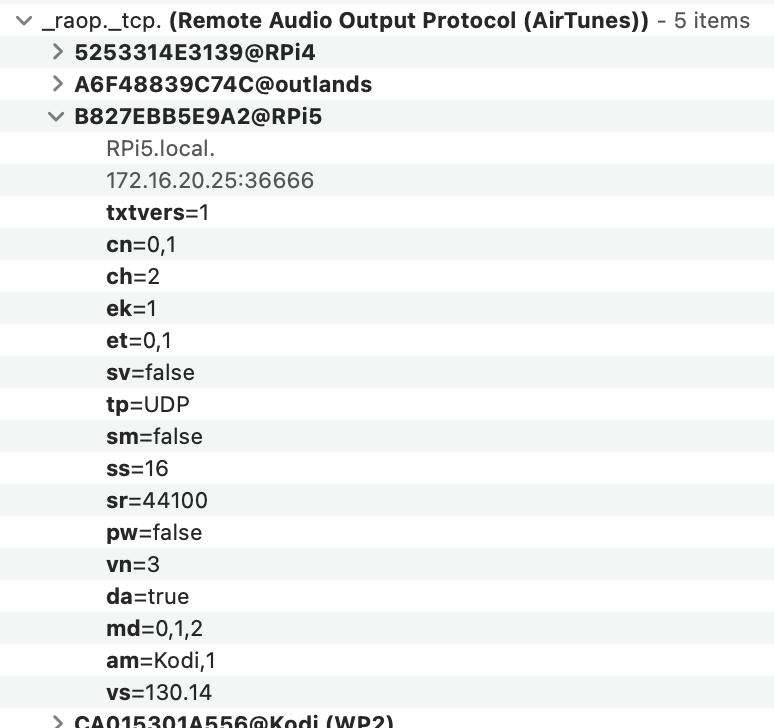

I run LE 12.0 nightly 2024-11-29 on RPi4B. Streaming audio from my iPad mini using AirPlay to the device works smoothly. But I now found that pipewire can use AirPlay to send audio to a device and wanted to see if I could make my Arch Linux laptop stream audio to the RPi4B. I have /etc/nsswitch.conf and avahi-daemon.service set up and port 5353 UDP open and followed the instructions here: https://docs.pipewire.org/page_module_raop_discover.html using the example configuration as starting point.
The RPi4B are discovered and I can send audio to it from the laptop and it's seemingly playing from there. But on the LE12 side I get the spinning wheel on screen as soon as the stream hits, but then nothing more happens (nothing playing). I tried to tweak various knobs in the configuration file example from docs.pipewire.org, but to no avail. Anybody got a working configuration for this or some pointers to stuff I could try...?
