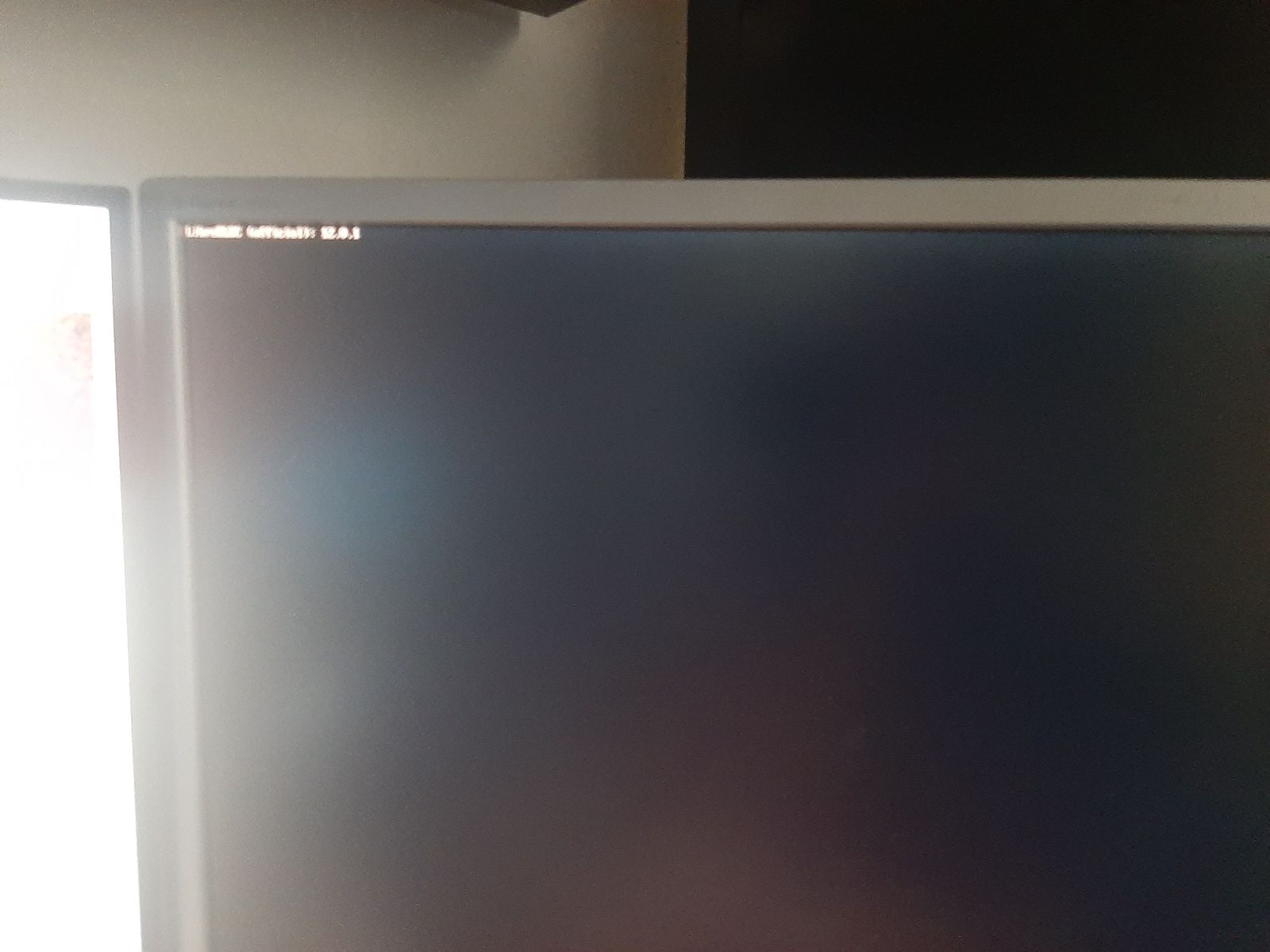

    Sometimes it stucks during boot. Showing just in corner the message "LibreELEC (official) 12.0.1"

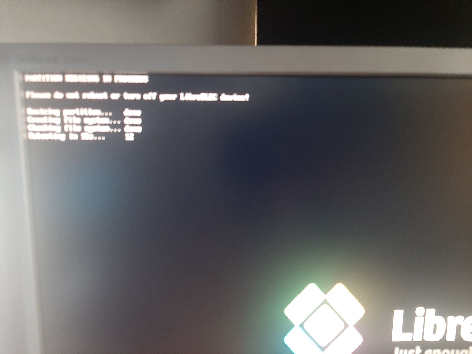

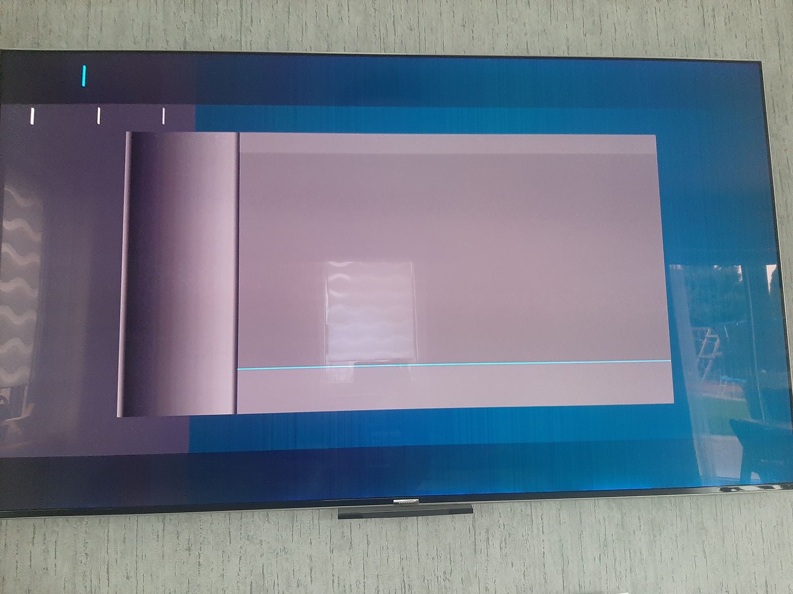

    Sometimes it starts "successfully" loading the initial Startup assistent from Kodi, but here is almost everytime the end. It does not show right. I can see that cursor is moving, and I can skip this menue by clicking several times enter, but even after a reboot it is showing just a few frames, no text...se pictures below.

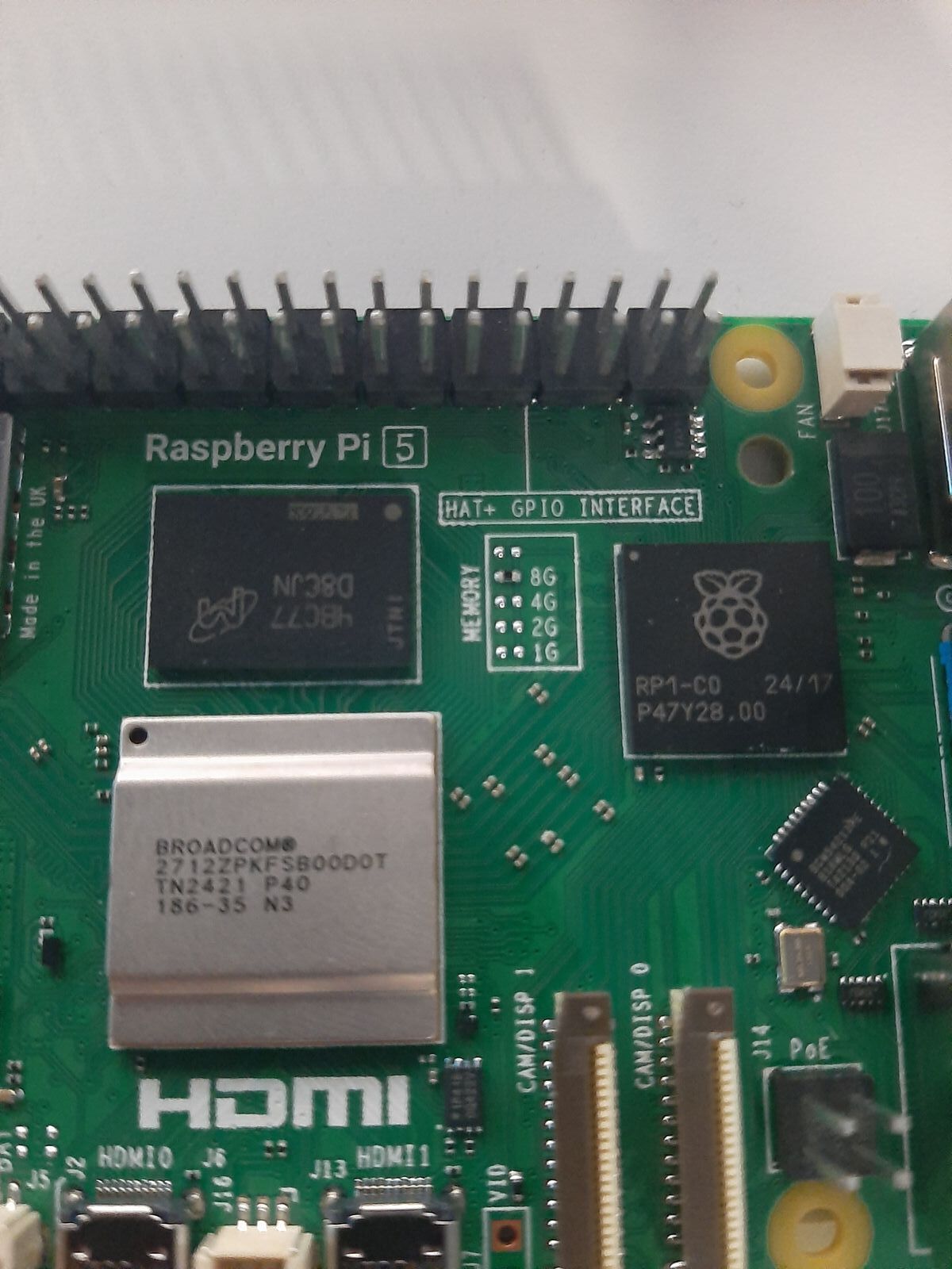

  • It doesn't look that you have got the 8GiB version, looks more like the hardware revision 2712D0 (released with the 2GiB version). Please try a recent nightly build, which includes the needed Mesa driver patches.

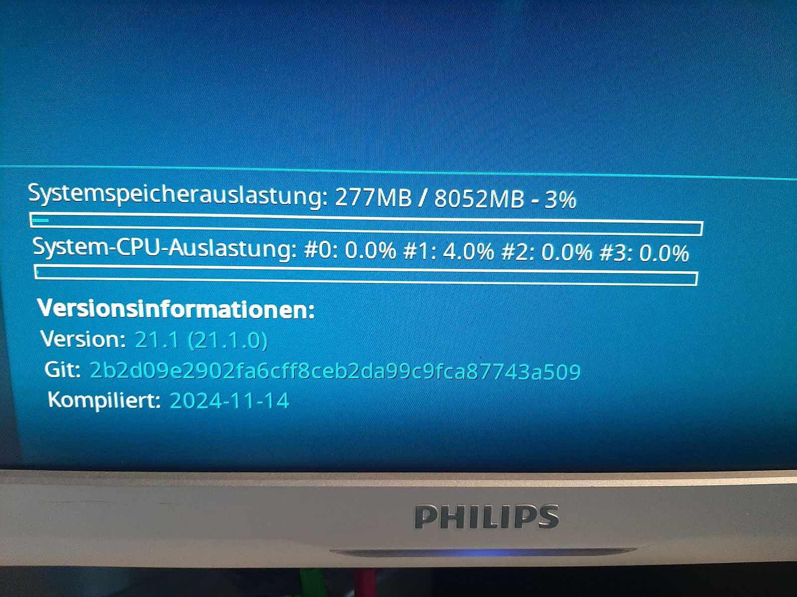

  • Hey, yes, the last nightly works.
    Thank you for the hint.
    An no, it is a 8GB Raspberry.
    But yes, looks like the MCU code is similar what you wrote:
    You are the first to confirm my suspicion from the linked thread that equipment variants other than the 2GiB version with this new chip version are in the wild. Nice to know.
