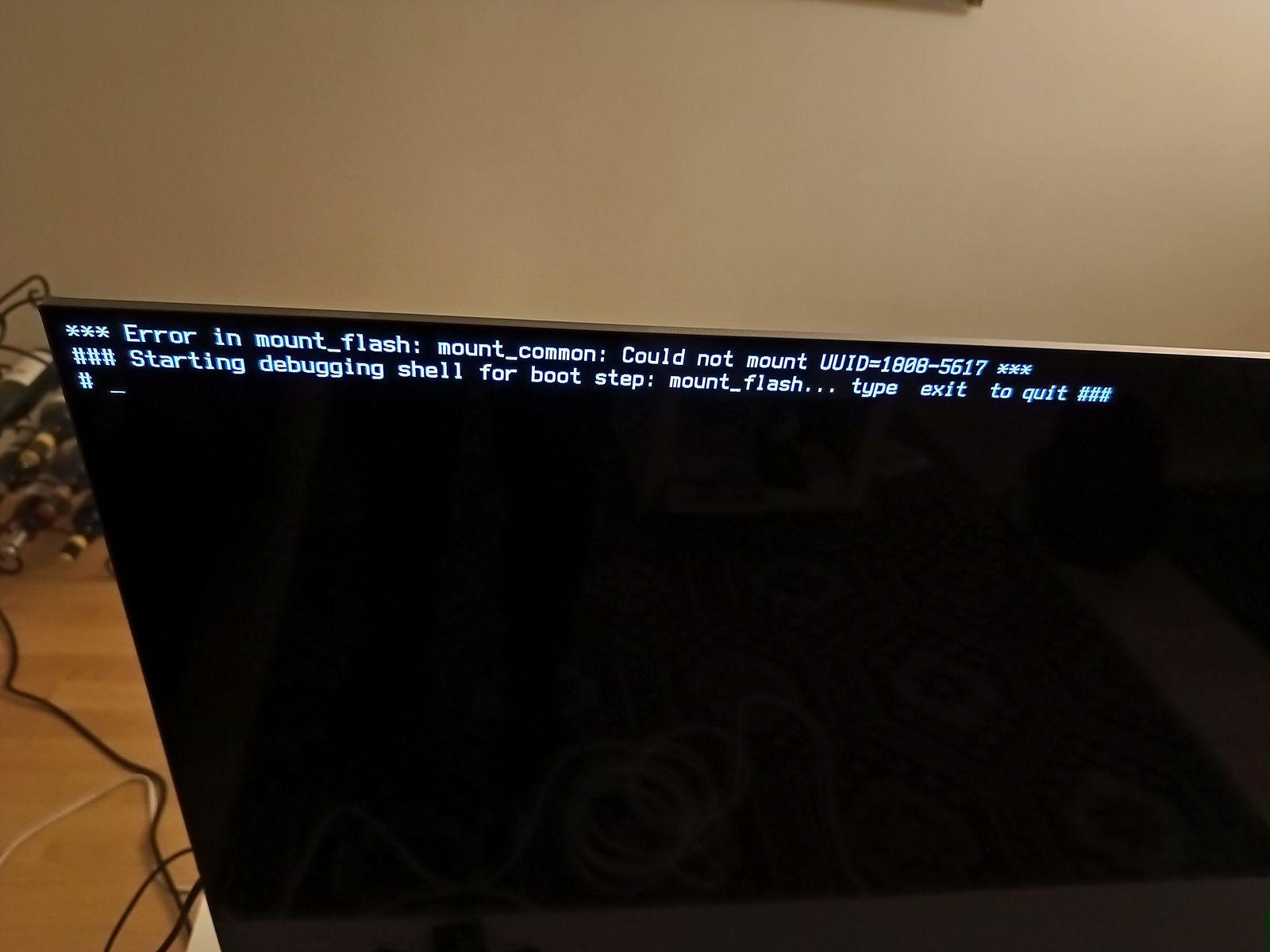

    My idea was to install libreelec on a 1gb internal nvme m2 ssd drive (wd black sn770) with the latest raspberry pi 5 8gb.
    I had the image LE file on the usb stick , started the pi up with the stick in and expected to see a menu were i could install LE on the nvme ssd . But i ended up installing the latest version just on the usb stick
    itself, i guess. Without the stick kodi does not run.
    In kodi (on the tv) menu system info / storage / i have now this (with usb stick (32gb) plugged in tv) :
    /dev/sda1 size 511.7M used 145M available 366.4M mounted on / flash
    /dev/sda2 seize 27.76G used 11.8M available 27.76M mounted on / storage
    So my question is how can i get kodi / libreelec on the ssd drive? What went wrong ?
