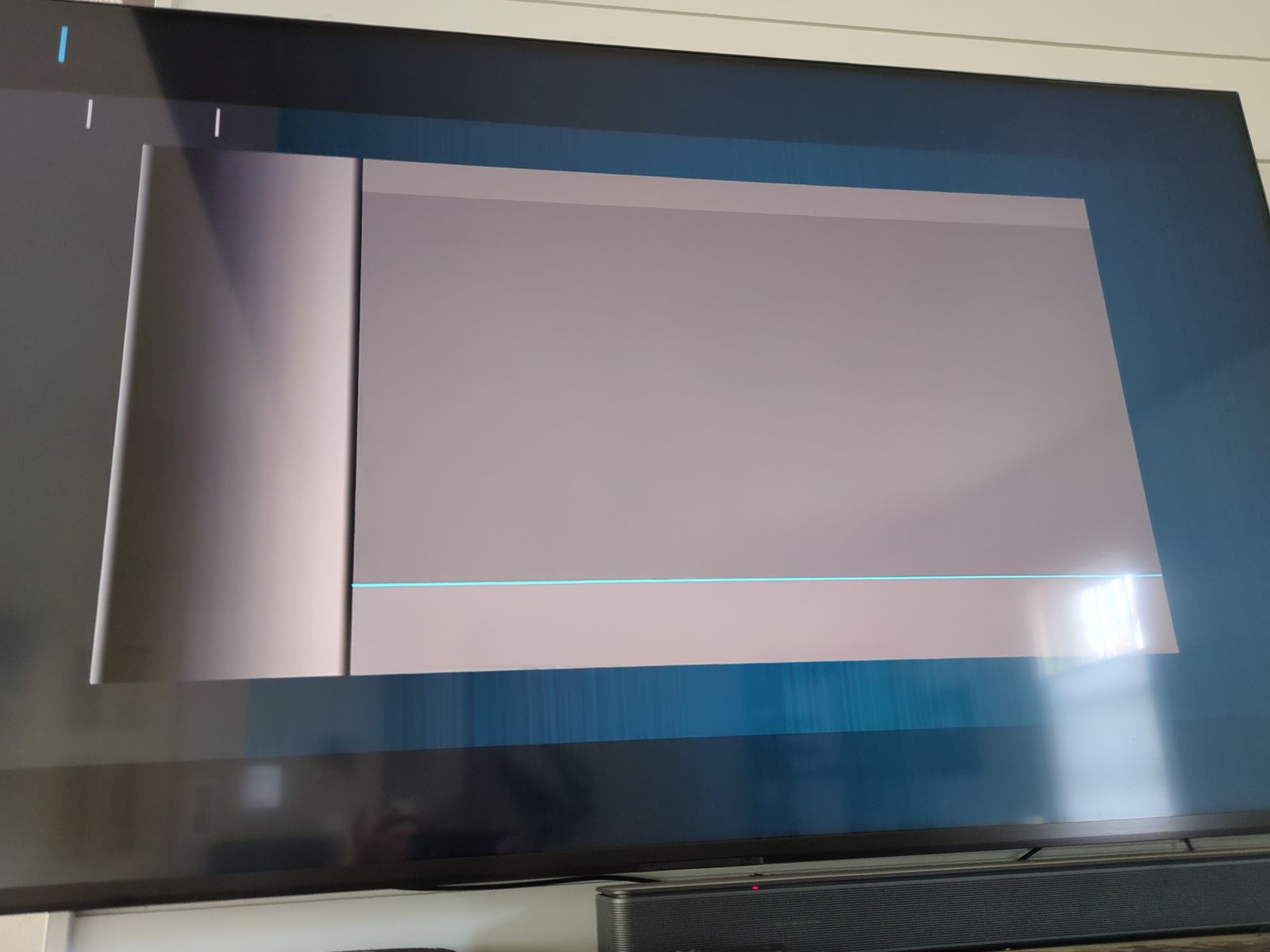

    I have a Bravia X90L series (55") and I just picked up a Pi5 CanaKit with all of the bells-and-whistles to double-sided tape a LibreELEC media center to the back of the TV over the fireplace. The version of LibreELEC is recent -- whatever came out of the business end of rpi-imager this afternoon.
    I basically don't get a signal from the Pi5 at any of the HDMI ports with the exception of the highest-end HDMI-4 (4K and a bunch of whiz-bang I don't understand) port. At Pi boot I get the LibreELEC boot splash and then the attached not-quite-right display state. I can use the remote to navigate something as I can hear the UI element audio indications but I cannot see what I'm doing in the UI.
    I've seen some posts about adjusting some display settings (ex: Deep Color) but I'm not finding them buried anywhere in the various menus of the Bravia.
    Perhaps someone could take a look at the picture and point me in a possible direction?

  • Rule out electromagnetic interference. Take the RPi away from the TV for a test, and use a proper HDMI 2.0 /2.1 cable.
    If it doesn't work, install Raspberry Pi OS on another microSD, and give it a shot. That's the gold standard OS for all RPi.

  • Do you use a RPi5 2GiB model? I can remember that you should use a current LE nightly to support that. I think the scrambled picture looks so...
    Mine is actually an 8GB. But perhaps the issue is not a function of amount of memory but something else?
  • Yes, you should give it at try. The chip hardware was reworked to reduce the production costs for the RPi5 2GiB model. Maybe that change is responsible for the special handling and for new production lots of other models it's needed too now. Only a assumption...

  • Well, shoot. I just tried the nightly and got the same results as to the corrupted display. I have a PiKVM bouncing around here. Does LibreELEC boot include a serial console? If so, I suppose I could tap into my Pi and get some debugging information.
  • RPi4/5 boards don't support 4K60 at HDMI 4:2:0 which causes some issues with TV's that default to that mode. This is when config might be needed on the TV side to enable special modes (LG calls it Deep Colour, no idea what Sony might call it). However that issue will normally result in 4K50/59.94/60 modes not being detected and thus not being usable. It doesn't normally prevent you seeing the Kodi desktop. In your case it looks like something is being rendered (but messed up).
    If you add "video=HDMI-A-1:1920x1080M@60" to boot params in "cmdline.txt" (all on one line) it will force the initial HDMI output on the HDMI connector nearest the power connector to 1080p, which will eliminate a 4K issue from suspicion. If you also add "ssh" to boot params it will force the SSH daemon to start so you can SSH into the device to run "pastekodi" and share logs (share the URL generated here).

    HarryH Wow, that was buried in the menus! You must have either a photog memory or a Bravia. :D As it turns, that setting was already enabled.
    chewitt This corruption is happening at first boot. I'll look to see if there is a single user mode or some way to pause the boot loader to see if I can add those troubleshooting options. Thx. Stand by.

    I added the video= line but I'm still getting the same corrupted video.

    I plugged the Pi into an low-end Dell 27" monitor just for kicks. Same result. Also swapped cables and tried both the stable and nightly builds. Also same results.
    Seems like there is some sort of problem with Pi5. Or at least *my* Pi5.
