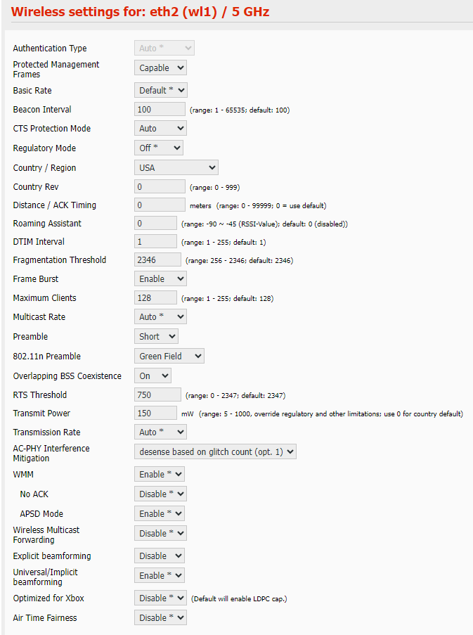

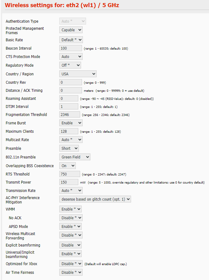

    Still there are a few things going on here and first and foremost, I believe the problem with Invalid-Key I am having relates to my 10-year-old NightHawk R7000 router running FreshTomato Firmware 2024.1 K26ARM USB AIO-64K with Linux kernel 2.6.36.4brcmarm and Broadcom Wireless Driver 6.37.14.126 (r561982). My settings ('Advanced'-->'Wireles') can be seen here.
    Additionally, the Invalid-Key issue was particularly heinous because I have a half-dozen storage-*.mounts in /storage/.config/system.d/. They attempt to start/mount prior to autostart.sh. Of course they are bound to network-online.service. So, I made sure that they were defined with BindsTo=network-online.target. Still on LE 11.0x I would sporadically get the Invalid-Key. I would more often need to restart LE and as a result not have my storage mounts mounted and then need to reboot again and again, until I could connect. I have addons, backgrounds, favorites, iconds, backups, and more mounted this way so when this happened, Kodi looked pretty gnarly. Barely useable and required a reboot and flip a coin if it connected this time.
    The problem persisted on LE 12.01 although admittedly significantly less. I played around with connmanctl, and in time noticed the errors that made me look at my router. Again, its FreshTomato and honestly I can't find anyone who knows what all that crap on 'Advance' --> 'Wireless' page of the FreshTomato UI means. So, I went to ChatGPT. The settings above are what it suggested for compatibility with a RPi5.
