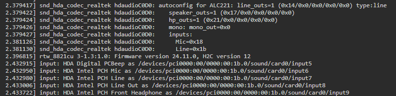

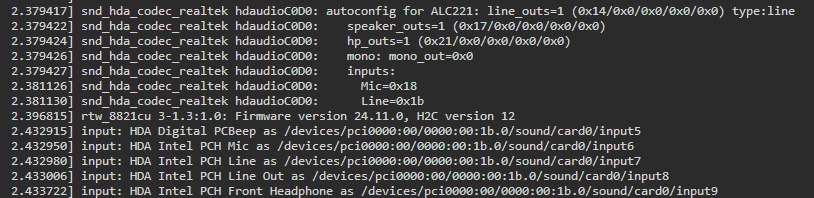

    I repurposed an HP build of mine to be my HTPC. Until recently, I was running Windows 11 on it, but I figured that LE would be a way better alternative seeing it's way more lightweight.
    To my disappointment, after setting it up and trying to play my first movie, I found out that there is no audio being outputted by the TV. There is also no way for me to use HDMI audio, as there are literally no HDMI ports on the motherboard itself and I am using an iGPU.

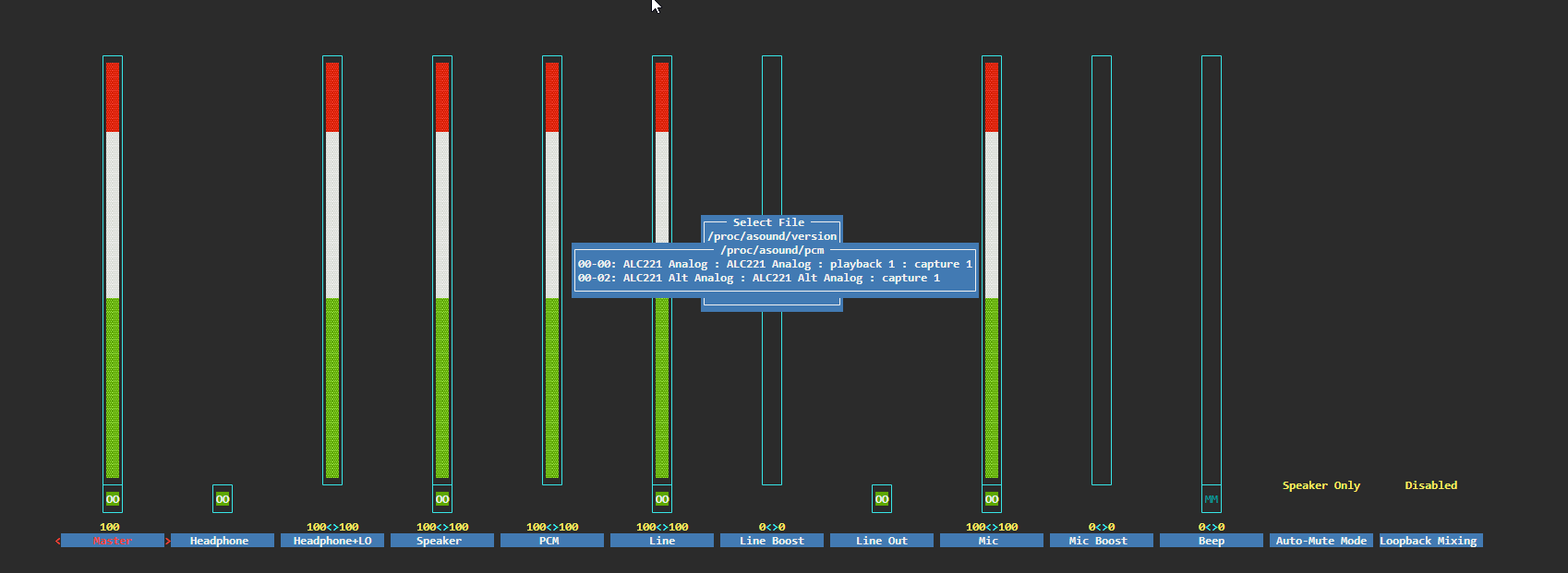

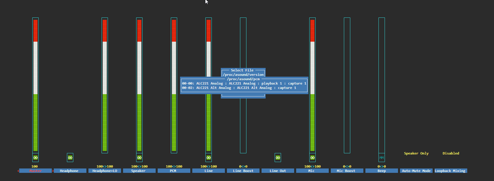

    Running dmesg, I found out that the audio driver is the Realtek ALC221. Using alsamixer to crank everything to max didn't help either.
    I've attached a few screenshots which might help someone identify the cause of the problem.
    Thanks in advance!
