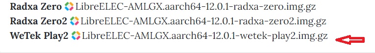

I burn Image 12.0.1 for wetekplay2, insert and ON the box, but it start in Android as usual, which is missing here ?

READ: https://wiki.libreelec.tv/hardware/amlogic (then use the correct image; hint, it's not the WP2 image).
