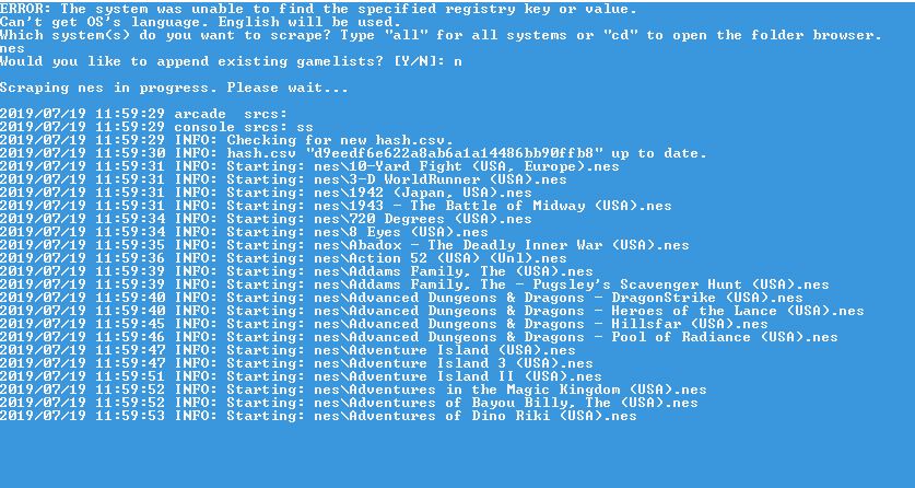

When I try to run the batchfile I get this error.
Strange...its working for me..just tried it now...What OS are you on? Windows?

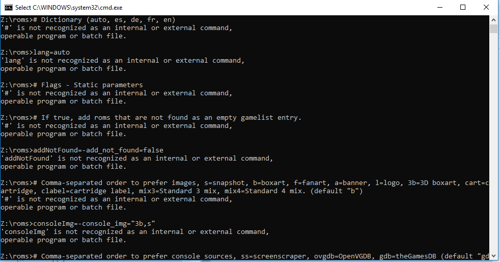

Thank you very much for this. It is very much appreciated. However, I have the drive mounted and the batch file in the roms folder. When, I try to run the script it runs the script very quickly and closes out. I am able to stop it before it closes if I click the mouse really fast to catch it. I was able to get an attached screenshot of what it is saying. It says "It says it is not recognized as an internal or external command" for every line. I even tried to run this on a separate computer (windows 10 also) and got the same result. I tried turning off antivirus, firewalls, etc...still the same. I even googled this problem, followed this article A command is not recognized as an internal or external command, and still got the same result.
I think that is the linux/mac version ![]()
You need the fastscraper.bat..
rename this from fastscraper.txt to fastscraper.bat and enter your user and passfastscraper.txt
Also the script will only download 1 type of image for every rom at 1 go..so just "3b" is enough for image command...if you want to download a screenshot set after just edit the command to "s" and run script again...but before running dont forget to rename the folder of scraped images because the script will replace the already scraped images in that folder...it doesn t create another folder..

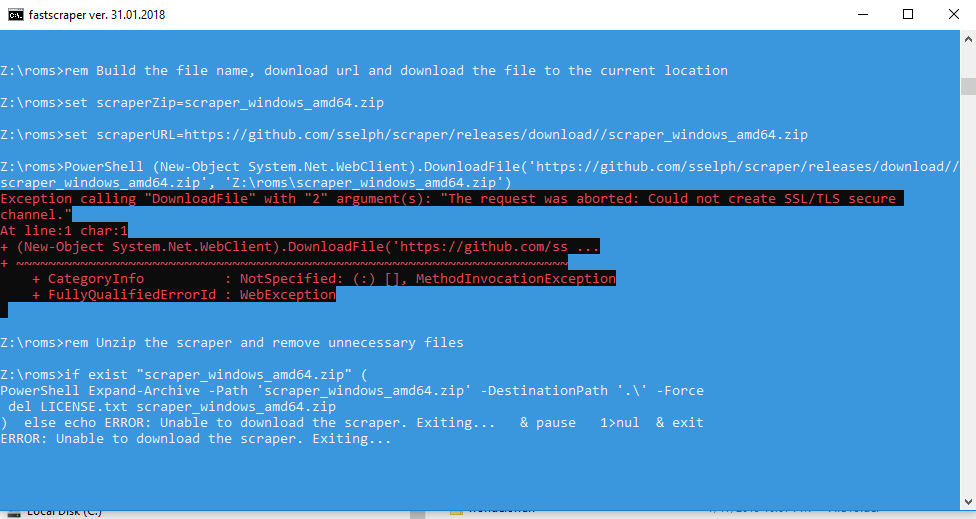

Ok thanks. I got the script to run but now it's not downloading the scraper. The screenshot is below.
try to run script as administrator..if it doesn t work try to create a folder on your windows 10 and run script in there so it downloads the scraper and then move scraper to mapped roms folder..

Tried everything you mentioned and still the same result. I'm thinking it has something to do with mentioned here Fails to set version, fails to download with manual inclusion of version... · Issue #16 · paradadf/recaltools · GitHub, but I'm trying to make sense of it or figure out what I need to edit.
Now I m at work...tonight i will post you a link with my scraper.exe..i have win 64 bit..or try to find the url from the script and download manually...you need to look for sselph scraper

Thanks man. This worked with downloading the scraper. Really appreciate the help. Finally got everything working great. I swapped out my xbox controller for a ps4 controller and it is so much better. Paired right away and works great with the games. When I'm playing a game is there an easier way to get back to my ES rom list instead of exiting retroarch every time? For example, when I don't want to play a game anymore, I have to press the playstation button. That takes me into retroarch. I have to scroll through the menu and go down and exit retroarch to get back to ES. Just wondering if there was an easier way to do this.
