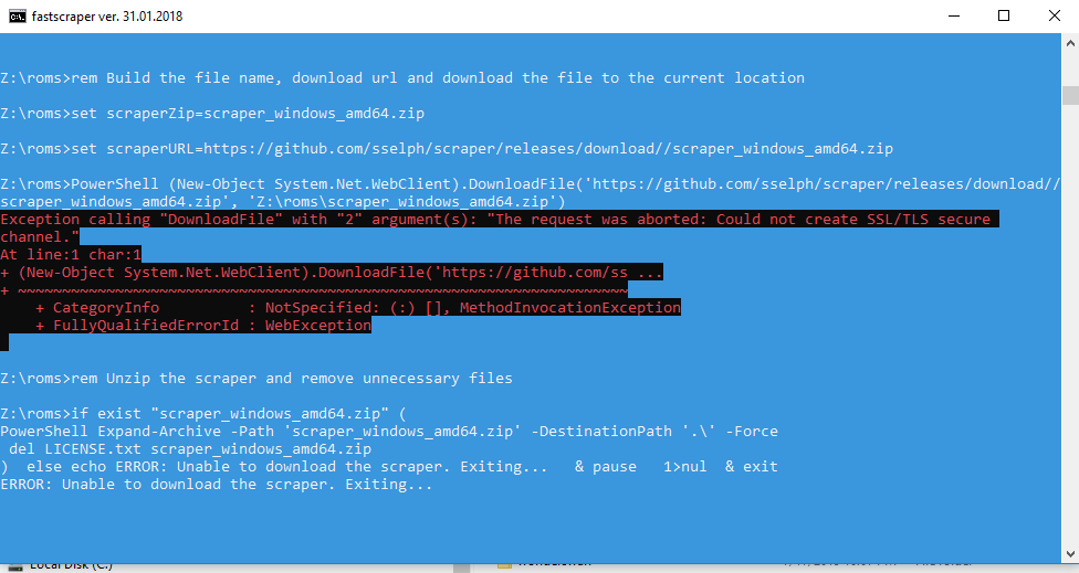

    try to run script as administrator..if it doesn t work try to create a folder on your windows 10 and run script in there so it downloads the scraper and then move scraper to mapped roms folder..
    option 2 will be instead of mapping your nas roms drive try to map the LE mounted emulators folder to windows..
    Tried everything you mentioned and still the same result. I'm thinking it has something to do with mentioned here Fails to set version, fails to download with manual inclusion of version... · Issue #16 · paradadf/recaltools · GitHub, but I'm trying to make sense of it or figure out what I need to edit.

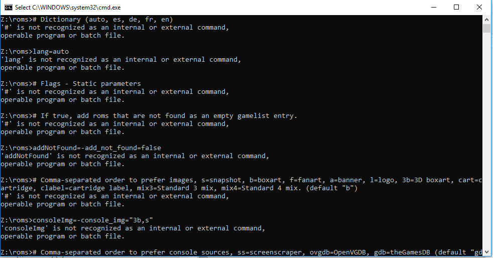

    Thank you very much for this. It is very much appreciated. However, I have the drive mounted and the batch file in the roms folder. When, I try to run the script it runs the script very quickly and closes out. I am able to stop it before it closes if I click the mouse really fast to catch it. I was able to get an attached screenshot of what it is saying. It says "It says it is not recognized as an internal or external command" for every line. I even tried to run this on a separate computer (windows 10 also) and got the same result. I tried turning off antivirus, firewalls, etc...still the same. I even googled this problem, followed this article A command is not recognized as an internal or external command, and still got the same result.

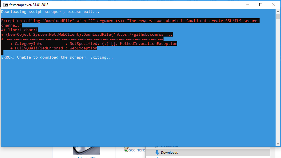

    When I try to run the batchfile I get this error.
