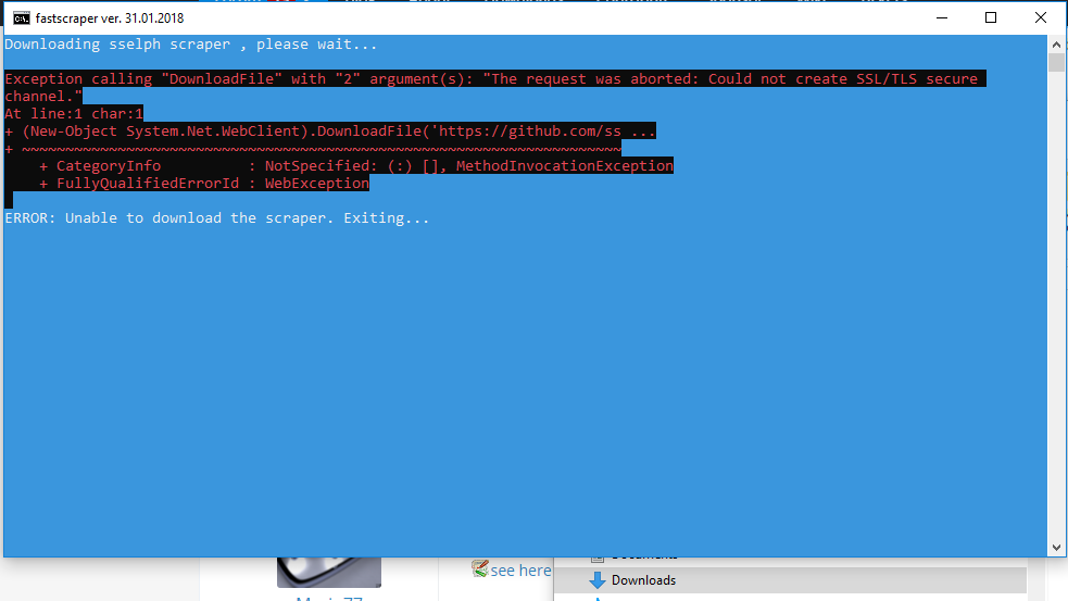

  • When I try
    When I try to run the batchfile I get this error.
