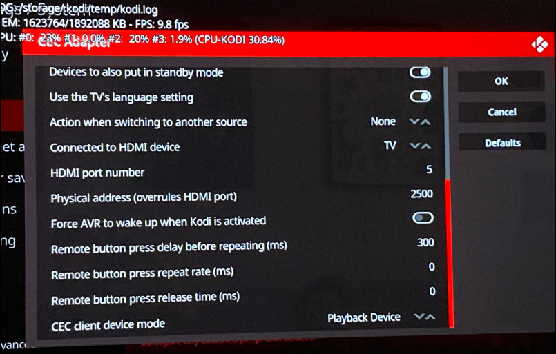

  • Running LE 11.0.6 on a Pi 4. Pi 4 is connected to a Denon X2400h via HDMI 5, Denon AVR connected to Panasonic OLED TV via HDMI 2 (ARC).
    These are my CEC adapter settings after doing all the operations below. Note that it switch to TV as connected HDMI device instead of AVR as I initially set it up with no way to make the correct setting "stick".

  • I can confirm, that strange behavior. After some attempts without success, I had let the port assignment in the default position 0. The things like remote control of KODI, TV off/on seems to work most of the time. I hoped that it was fixed with LE12, but I can say „currently no“.
    But it seems now a unexpected „feature“ of self sorting and self hiding of entries in the settings menu implemented. ;) So I thought it's currently under construction... /shrug
