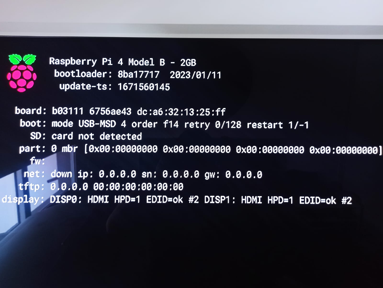

  • Thanks. I've asked a developer, and he answered this:
    Quote
    Standard procedure: what does the bootscreen say in the "display:" line when booting without any sdcard / USB drive /... attached?
    Note: this requires an up-to-date bootloader eeprom installed (i.e. run "rpi-eeprom-update -a" via ssh)
  • Funny that the HDMI-1 is still connected to the AVR and I can get video disconnecting the USB Drive.
    For that reason I bought a better Power supply for the Raspberry Pi 4 (5v 4a) because I thought that the power was not enough.
    AVR is still without electrical connection.
    Edited once, last by EloyFarina (February 11, 2024 at 8:04 PM).
  • I'm starting to feel like postal service ^^. Reply to your screenshot:
    Quote
    hmm, that looks OK.
    please tell the user to add drm.debug=0x04 to cmdline.txt and post a new log.
    Also please ask him/her to run modetest | pastebinit and post the URL

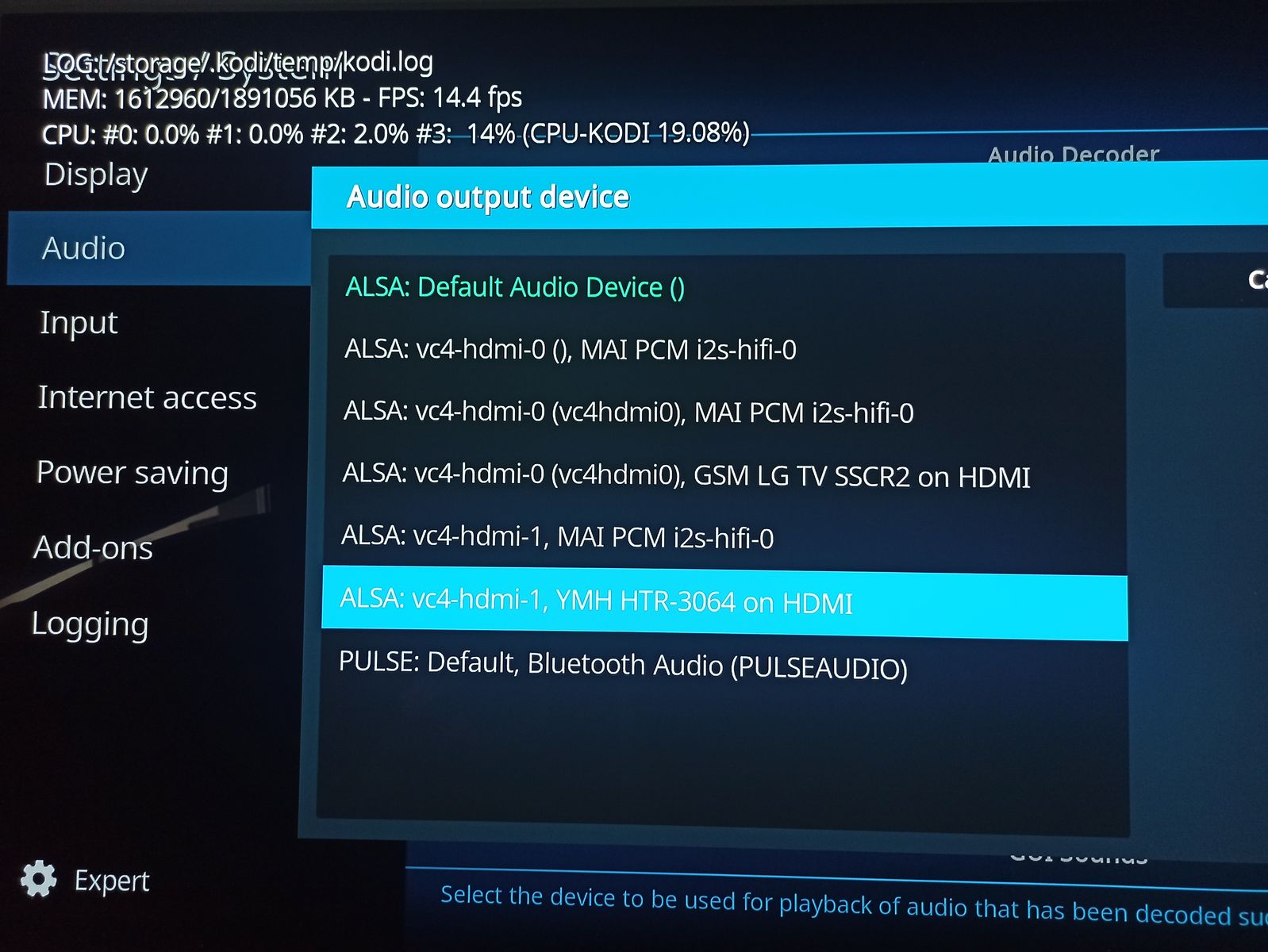

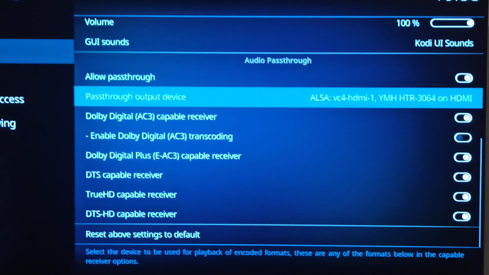

  • The user MikeKL that he helped me on the previous post and who faced with a similar issue, he recomended to create a EDID and based on the logs that I've shared here, he wrote the following
    Video
    m_deviceName      : hdmi:CARD=vc4hdmi0,DEV=0
    m_displayName     : vc4-hdmi-0 (vc4hdmi0)
    m_displayNameExtra: GSM LG TV SSCR2 on HDMI
    Audio
    m_deviceName      : hdmi:CARD=vc4hdmi1,DEV=0
    m_displayName     : vc4-hdmi-1
    m_displayNameExtra: MAI PCM i2s-hifi-0
    Then I noticed something. I remembered that I took a screenshot when everything was working fine, just to document it in case that I need it in the future. "YMH HTR-3064" is not in my previous logs
    Reason is that when I pulled the logs, the AVR is not connected to the electricity as I showed in the video.
    Since now I will have the AVR plugged to the electrictiy to took logs and troubleshoot, and I will create an EDID with YMH HTR-3064 and for m_displayName I will set vc4-hdmi-1 (vc4hdmi1)
    I will keep you posted shortly
