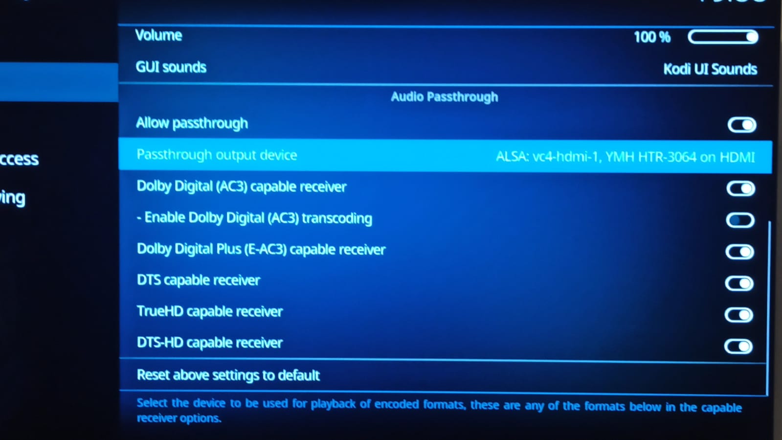

  • MikeKL, thanks for continue helping me. When I saw your message I put the focus on MAI PCM i2s-hifi-0, I'm pretty sure that It's not the Yamaha EDID. Let me show you this screenshot that I took when everything was working fine days ago:
    Now keep in mind that to make simple the troubleshooting, the AVR is not connected with electricity. That's why the EDID is not showed, so should I connect to electricity the Yamaha and replace "MAI PCM i2s-hifi-0" to "YMH HTR-3064"?
