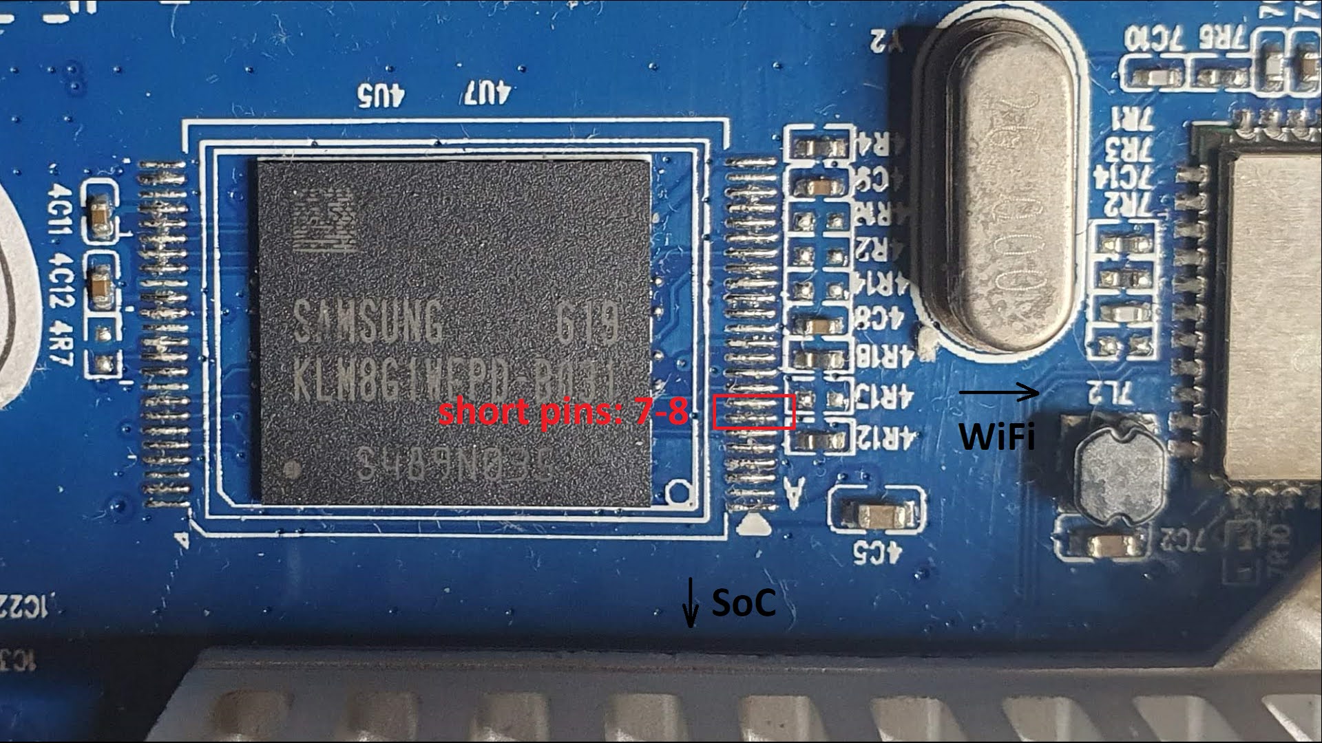

Currently the only solution to boot from recovery sdcard is the emmc pin shorting method (I haven't tested this):

I also reread the mentioned threat in my openings post and I overlooked initially that erasing the EMM / make it unbootable forces the Uboot loader to find another boot medium and enables the boot via the SD card again.
There is only one way to find out, and not having currently an option to unbrick my unit makes this me a bit hesitant as if this does not work my unit is permanently bricked.

Hardware disable EMM (as mentioned by dtech ) boot the unit and enable the EMM again ( I am thinking putting 2 wires to pad 7 and 8 and a switch to tmp short / disable the EMM during boot and enable it as soon the SD card boots).

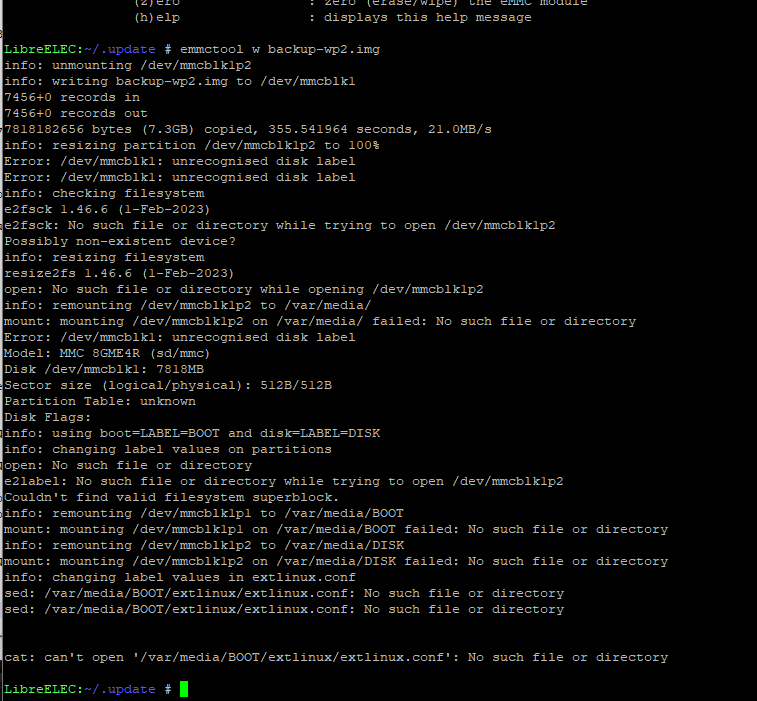

I did the gunzip on the device this is SLOW 30 minutes or longer .. so for a faster procedure use 7zip or whatever you use on your workstation to extract the backup-wp2.img file from the backup-wp2.img.gz and copy this directly to the share.
Than revert back to the SSH shell and use emctool to write the image to your EMC emmctool w backup-wp2.img.
This is also a slow process 10 to 15 minutes or so and will give a few errors no worries this was my output :

Ahh, I've forgotten that the 'w' option tries to resize etc. after the dd/writing stage; and all that will of course fail as emmc doesn't contain an LE image after restoring the backup. It doesn't cause any issues though.
