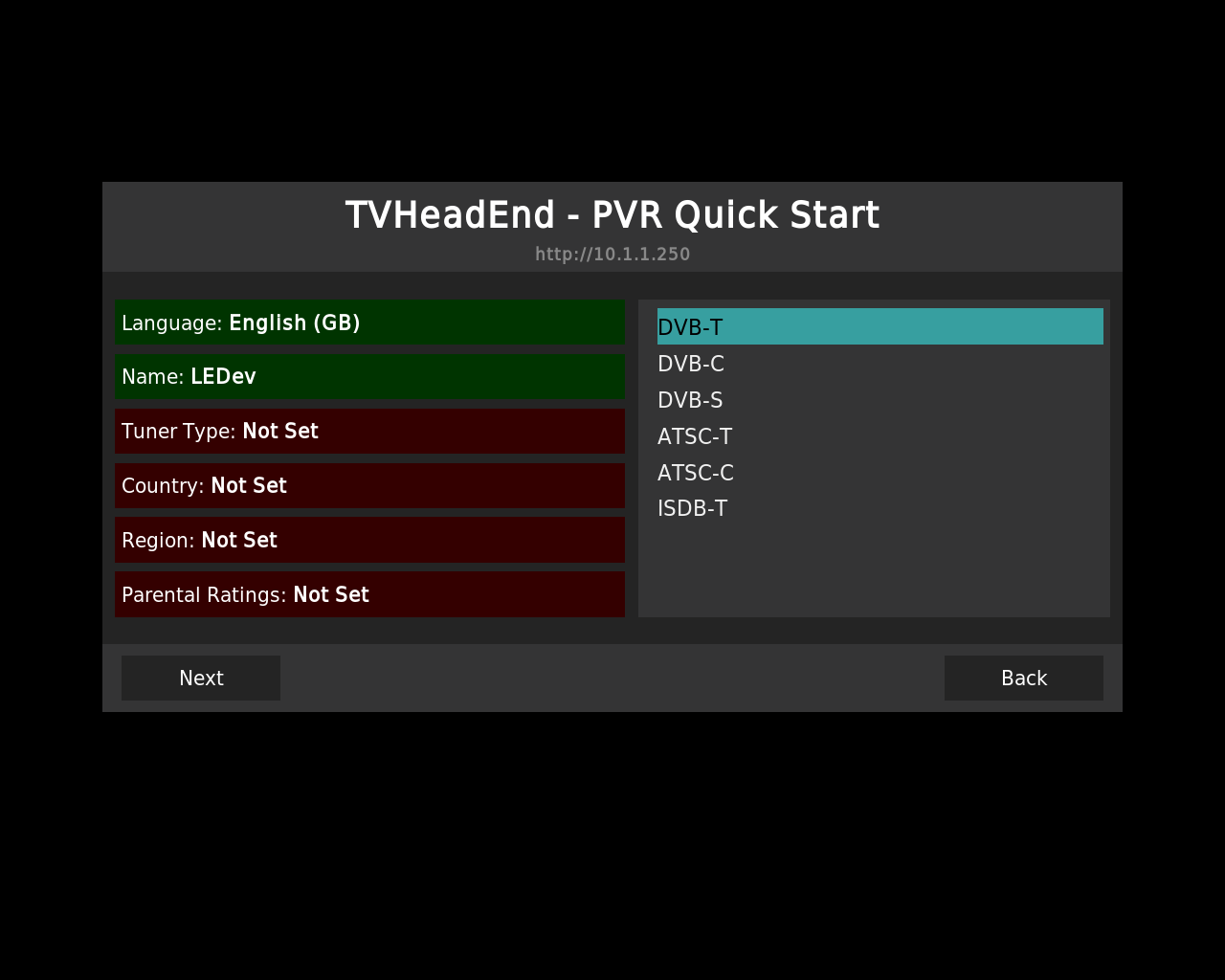

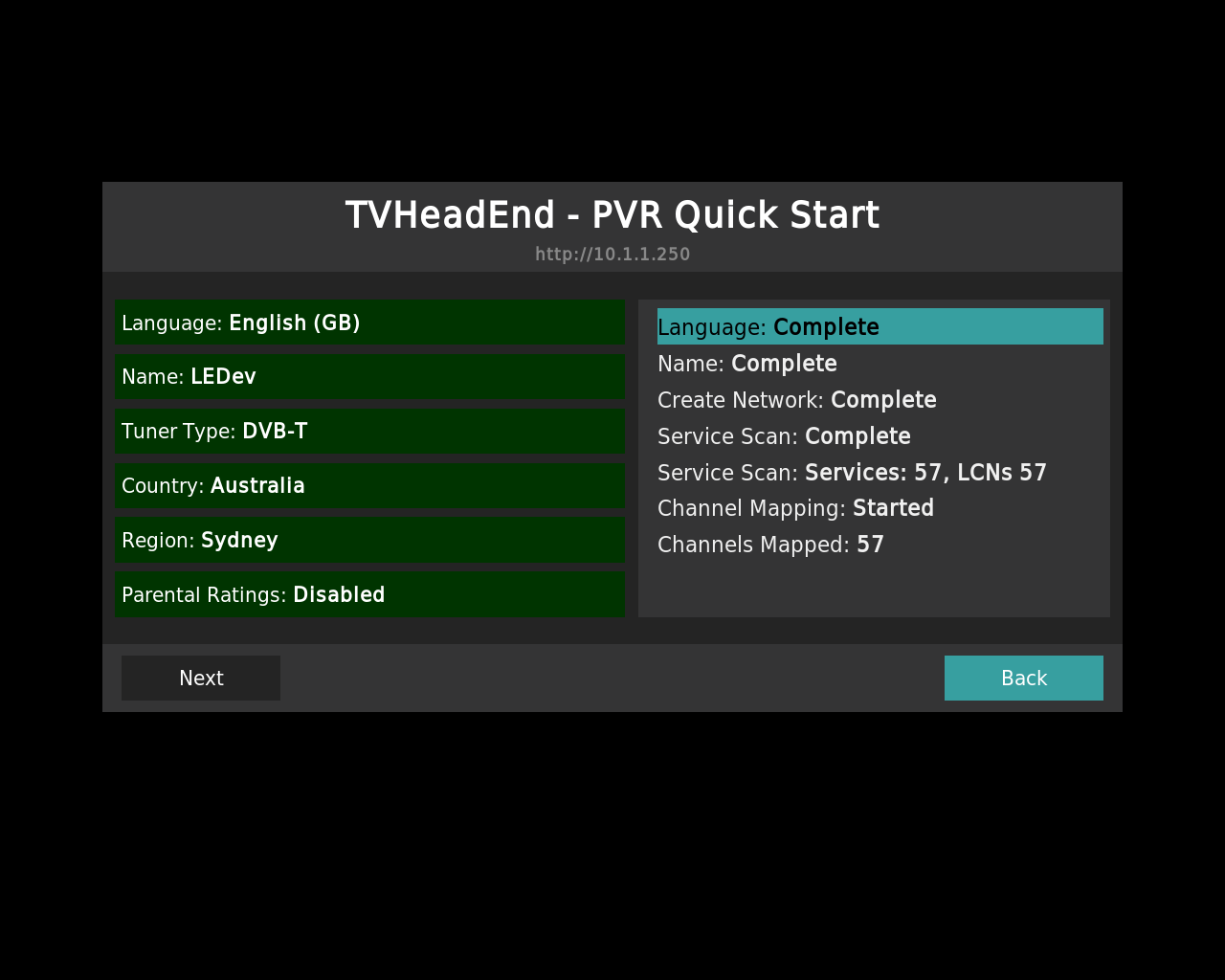

  • I managed to clear all the bugs that were stopping me from running the tvh2kodi DVB-T Wizard (there may be other unrelated bugs). Here are the steps that the wizard takes:
    • Start Wizard
    • (Are you sure?)
    • Select a single tuner
    • Select location mux list
    • (Full scan plus progress)
    • (Report on number of channels created with a message “You can now enable additional tuners in the adapters menu”)
    In addition to this, the Wizard silently created ‘Channel Tags’ within TVH for HD, SD, TV & Radio channels.
    What follows is a comparison, not really a critique per se:
    It only configures a single adapter. If you have multiple adapters servicing the same transport, the others will need to be enabled manually or have the Wizard run a second time. My wizard grouped the adapters by protocol and processed all of the adapters in that group.
    The UI language is not set in TVH based on the Kodi language. TVH remains as English. Some of the Kodi dialogue boxes are localised, however, the vast majority of the addon is in English, hard-coded in the scripts.
    The TVH server name is not set. This is not really a big deal though.
    The muxes are presented in a single 1119 item list not separated by country. Great for me in Australia, not so great for people in Vietnam. My wizard was going to group be country and then region.
    My wizard did not yet create channel tags, however, I was planning to create tags by provider name.
    At the mux selection stage, the 'Cancel' button does nothing. The Wizard just keeps going.

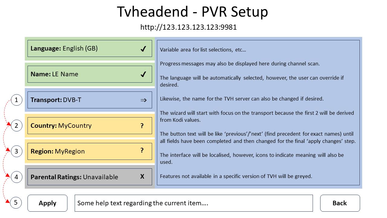

    Attached are my thoughts on the workflow layout. Colours, text, icons, etc, yet to be determined.

    I still think EPG needs to be right after "transport", sure you can have TV without it but it is not PVR. People need to think about this right from the beginning, IPTV user are used to them being in parallel.
    Transport is a bit technical too, maybe "Tuner Type". I don't consider SAT>IP a transport. Same for the Silicondust devices which are the most popular here.
    Country and region are DVB-T/T2 and DVB-C related, so need to be optional. The pick lists do need to be based on the new standard for LE https://git.linuxtv.org/dtv-scan-tables.git/ good or bad to avoid maintenance of the wizard. The hardest part is where does a user who can't find their country, city or the scanning table is crap go for help?

  • emveepee - ‘Tuner Type’ is a good suggestion, especially when it comes to localisation because ‘transport’ could also mean bus, train, etc. Thanks.
    The big box to the right of the screen is a flexible space. Perhaps Country and Region could be combined into that space with Country being a dropdown and Region being a list box populated based on the country selected.
