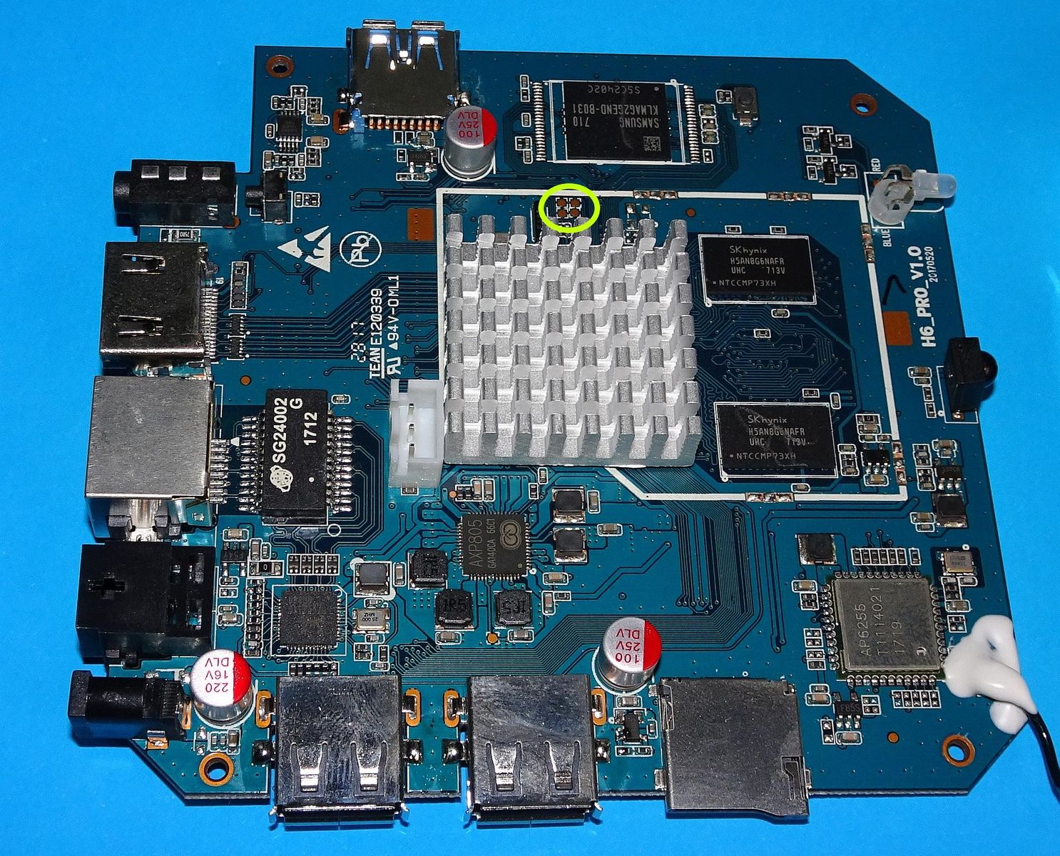

  • Here is picture of circuit board:
    ZIDOO H6 PRO Android 7.0 Allwinner H6 2/16GB AC WiFi Gig Lan BT4 L1 Widevine
    Today something new and little different ZIDOO H6 PRO Android 7.0 Allwinner H6 2/16GB AC WiFi Gig Lan BT4 Has been a long while since we have had a Allwinner…
    forum.xda-developers.com

    I think maybe I am facing the same problem. Zidoo H6 is equipped with DDR4 RAM.
    I will have a try to see whether these 4 pads are uart pins when I have time. It looks there is no other test points possible to be uart on this board.

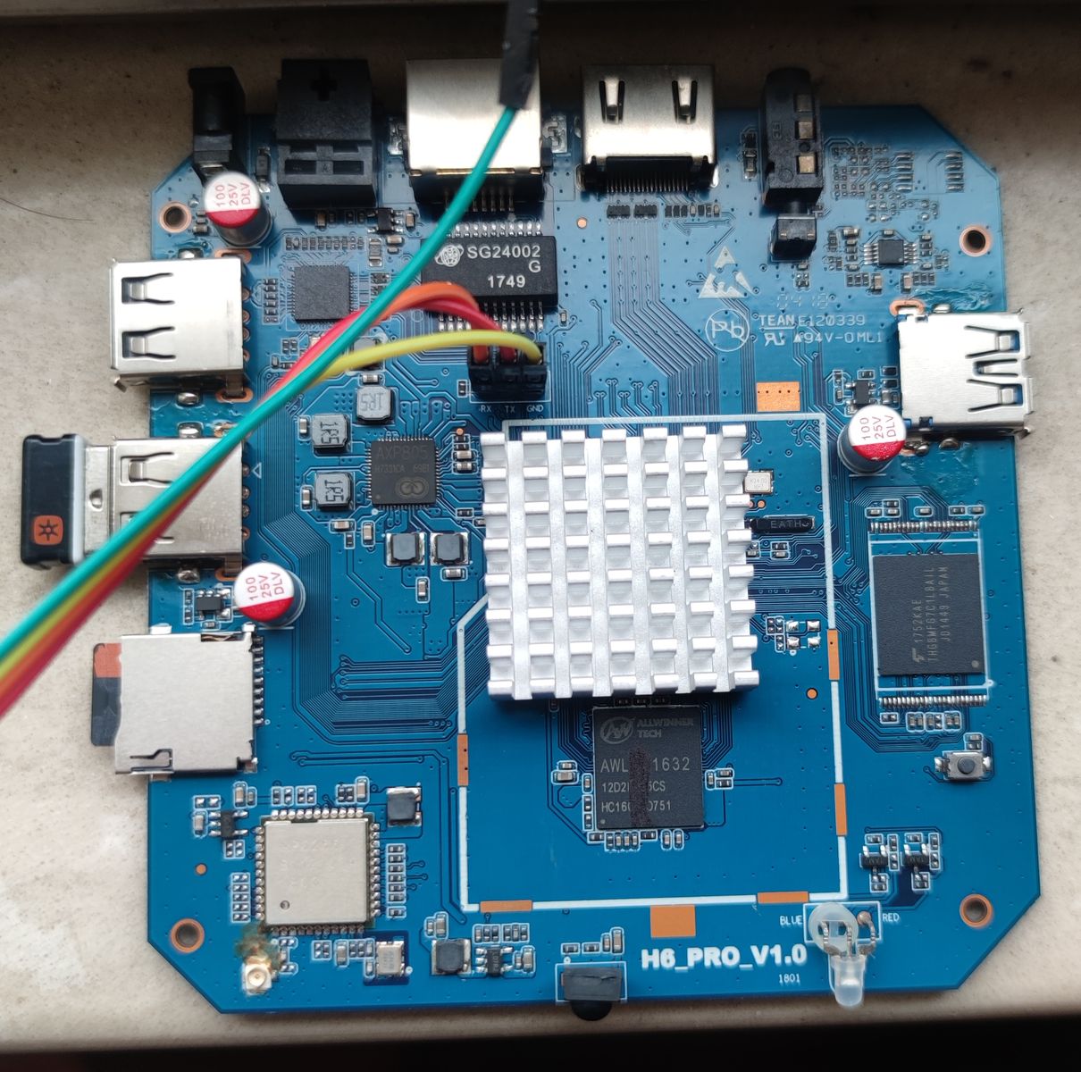

  • It turns out Zidoo changed design in 2018...
    Those 2017 pictures are with DDR4 ram, but my "China Version" has DDR3 ram, exactly same chip as Beelink GS1.
    UART is already popped out so I saved some soldering work. BTW, TX/RX are actually reversed.
    This is the uart log:
    Insert LE tf card will get me same uart output and still boot into Android on internal emmc at /dev/block/mmcblk0.
    The LE card is recognized by the stock firmware at /dev/block/mmcblk1. It is not mounted in the console display printed by "df -h", but can be seen in Android file manager.
    I am going to create a card with phoenixcard and see what's the magic there..
    stock firmware image tf card written by phoenixcard will get this boot message:
    It gives "sdc0 spd mode error, 2", then turn to boot from mmc0(tf card) instead of mmc2(emmc).
