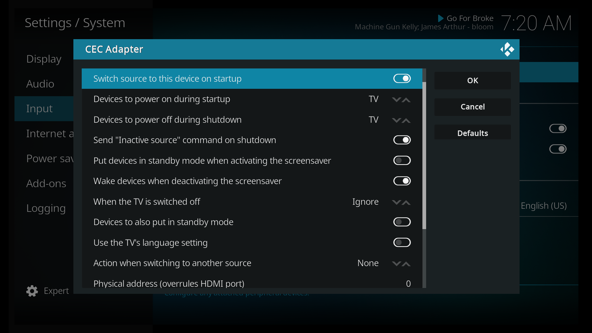

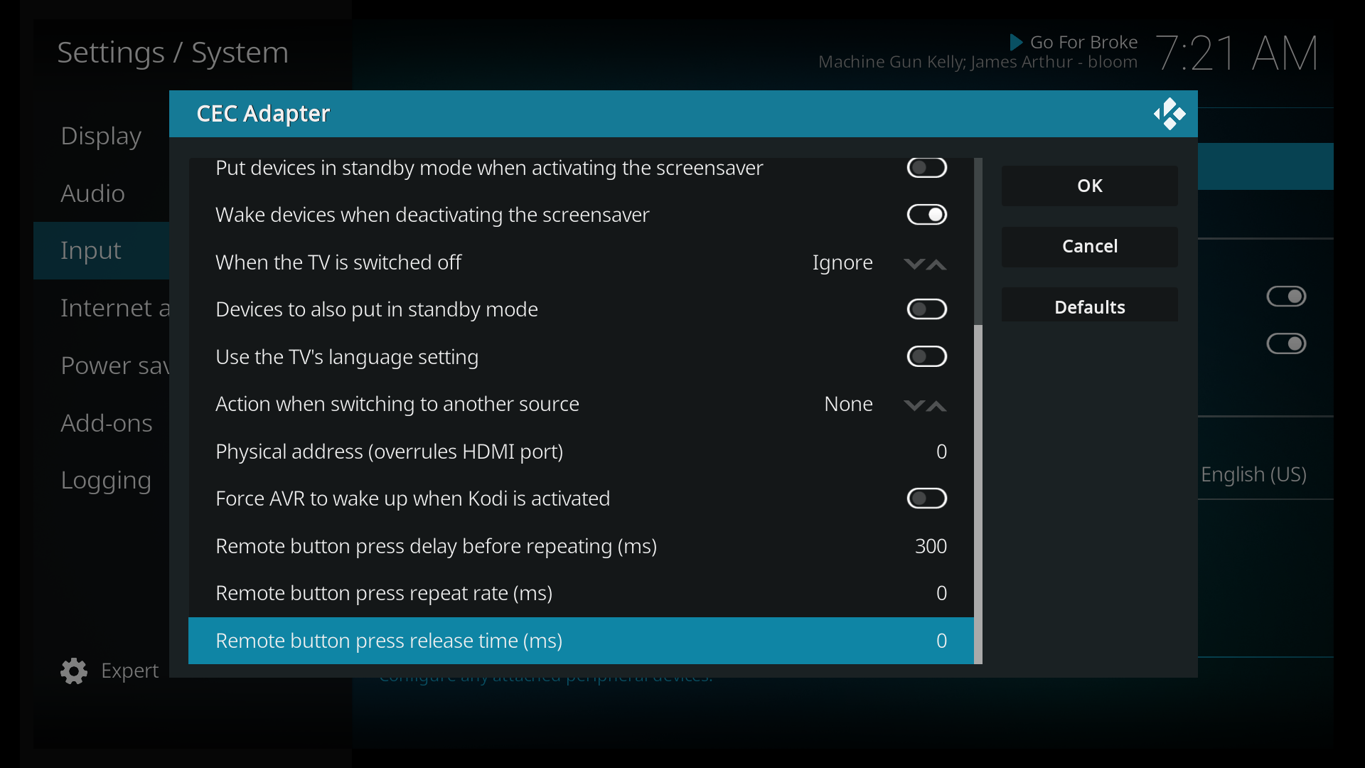

I have Samsung tv and avr with rpi4 LE10.0.0 connected and CEC works great, but any version newer of LE, when the tv turns on, the avr does not. I have tried all settings in newer versions and even 11 doesn't work.
