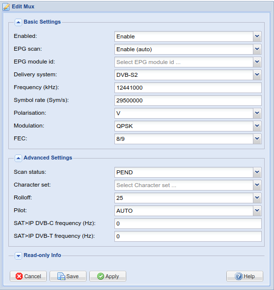

  • The board is a Hauppauge WinTV-HVR4000(Lite) DVB-S/S2. Dmesg output attached. Also: a mux I defined, copying parameters for one that was successfully set up during an automated scan. No scan was triggered. The status tab shows 1 transport errors and 34 continuity errors, w SNR and signal strength unknown (ditto for the DVB-T tuner for the last two).

    I may have found why the automatic scan didn't work when a mux was configured: the 4 LNB settings were unassigned; rebooting and reinstating as shown in the next attachment at least allowed scanning to resume as before.
