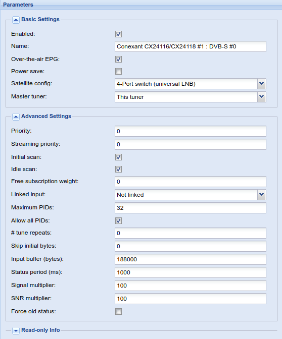

    I tried a universal LNB setting but got no data back from it; have used 4 port LNB with the AB port selected for years with no issue. The Diseq stuff was enabled by default and I never bothered with it before ; have now disabled it.

    No, unfortunately, I'm still seeing multiple listings for channels with v4.3. And have rediscovered that choosing a 4 port LNB option is required (no result from choosing a universal LNB).

    So far, as in with previous LE install (years ago; was on 9.2 prior to 11), I just selected 4 port LNB and then verified which of AA, AB, BA and BB was live. That worked. I'd just forgotten about this, also about Diseq (read the docs long ago and haven't needed to since and can ordinarily get by if it's something I've done before, but thanks for the link anyway). Ofc, I needed to select port AB and link to DVB-S Network to get any scanning to work, but that wasn't a problem as 4.3 was scanning ok.

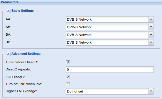

    I may be wrong about the LNB settings. It turns out that once selected they go grey looking unassigned. The LNB is a 4 port model but I don't know for sure which port is connected; I just checked them all, AA, AB, BA and BB (the box only has one DVB-S tuner) and let LE figure it out. Two of the other ports go to TVs and one is unused. I'll check what the config for 4.2 was tomorrow and try specifying one port at a time.

    I may have found why the automatic scan didn't work when a mux was configured: the 4 LNB settings were unassigned; rebooting and reinstating as shown in the next attachment at least allowed scanning to resume as before.

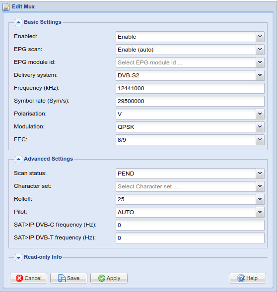

    The board is a Hauppauge WinTV-HVR4000(Lite) DVB-S/S2. Dmesg output attached. Also: a mux I defined, copying parameters for one that was successfully set up during an automated scan. No scan was triggered. The status tab shows 1 transport errors and 34 continuity errors, w SNR and signal strength unknown (ditto for the DVB-T tuner for the last two).

    I created a DVB-S network, didn't assign predefined muxes. Added a manually defined mux associated with the network, entered 10803 for frequency (10803000 KHz), ensured it was enabled, saved it, then tried to scan the network. Result:
    Scan queue length stays at 1.
