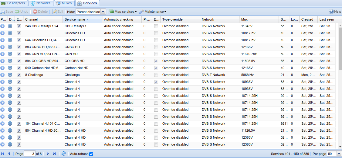

I've installed TVHeadend 4.2 with LibreElec 11 and created a couple of bouquets. I'm seeing 4 copies of every channel. No idea if this is a TVHeadend bug or not; same version has worked for me to date. Advice welcome. Thanks
Duplication of channels in PVR display

Are your muxes DVBS/DVBT or something else. Have you tried TVH 4.3 Alpha. A little bit more information would help. What hardware are you running this on.
Yes, DVB-S and DVB-T. No, I haven't tried TVH 4.3 as 4.2 was working ok to date. Hardware is X86 (Asus E45M1-M Pro motherboard with 4Gb RAM with a Radeon 450 to keep it from dropping frames; old but working perfectly and silently for a long time). Tuners are working fine.
I created two new bouquets, one each for terrestrial and satellite channels, and tried to get them working:
Add, External URL (the file: /etc/enigma2/Terrestrial.tv), Name: Terrestrial, Automap to channels: X, Offset: 0, Merge same name: X, Create tags: bouquet name)
However, Services and Services seen remain at 0.
Are you showing any sign of duplicate muxes. Is there any other instance of TVH running. Have your tried scanning the muxes without creating bouquets and mapped the results.
No other instance of TVH running and no duplicate muxes. I scanned the muxes and didn't map any results as I don't want any channels other than those in two bouquets I made. The advice I found for creating one's own bouquets was to do the mapping per bouquet.

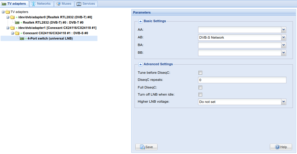

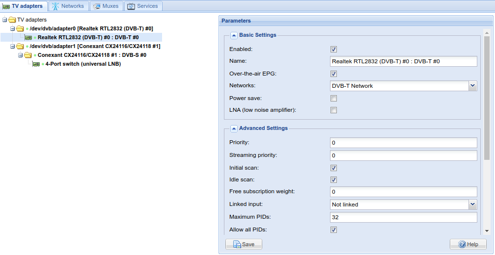

What brand tuners are you using. Have you got them enabled in the DVB Adapters section
Tuner is a Hauppauge model with Conexant CX24116/CX24118 #1 : DVB-S #0

When you are adding one mux to scan I assume you are supplying all the relevant information in the Basic Settings section, setting it to Active and applying it.
Finally, are you using an Hauppauge USB tuner. If so read this RE: TBS Drivers on LE10
