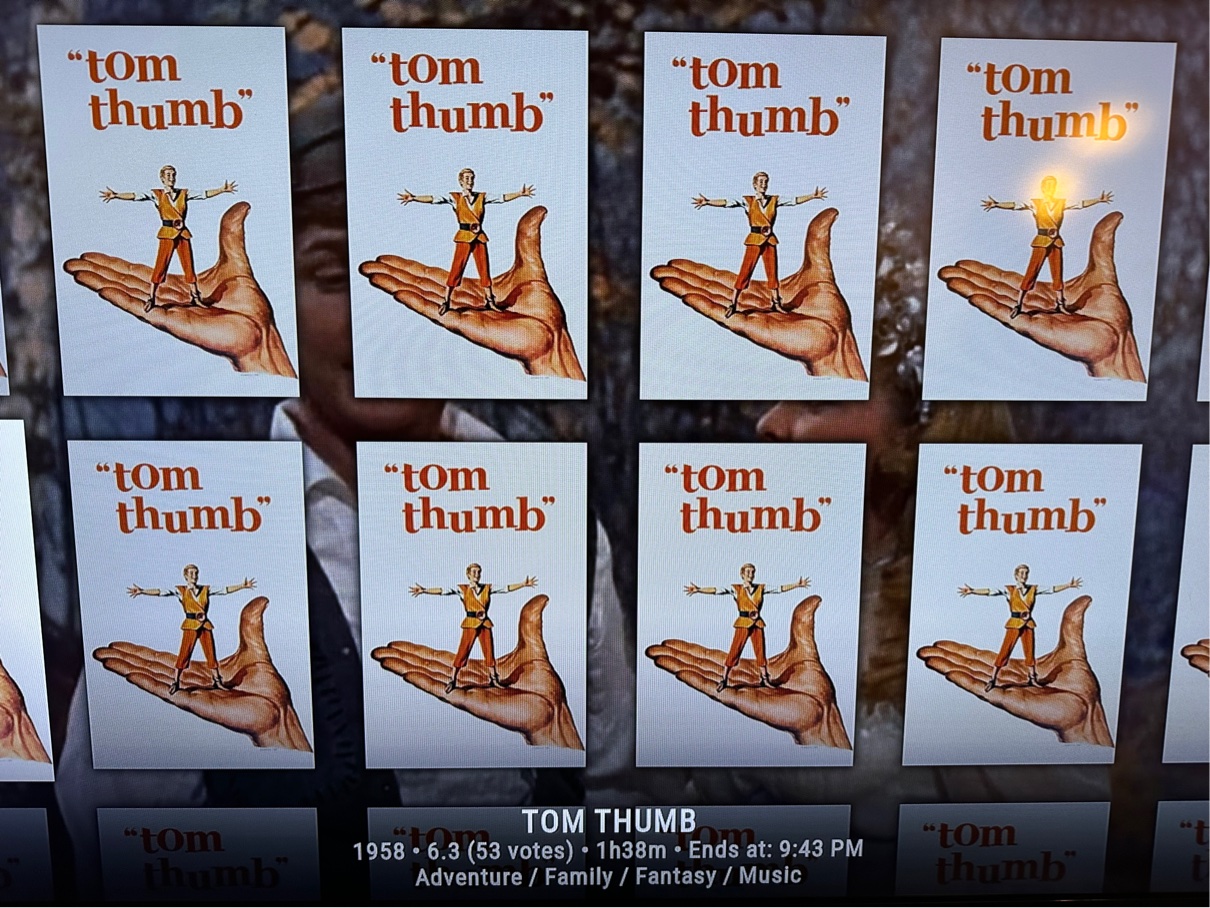

  • I was wondering if anyone has seen this issue before as I am not sure why it started or how. When I scan my NAS on startup and Kodi looks for shows, it ends up adding multiple .@__thumb files in the Movies and or TV section of random shows/movies. So then it looks like I have 6 of the same file because it creates 5 more, when in reality I only have one. When it does this with TV shows, I have no idea which one the real file is until I select each one and wait for it to play. When it doesn't play, I delete that file.

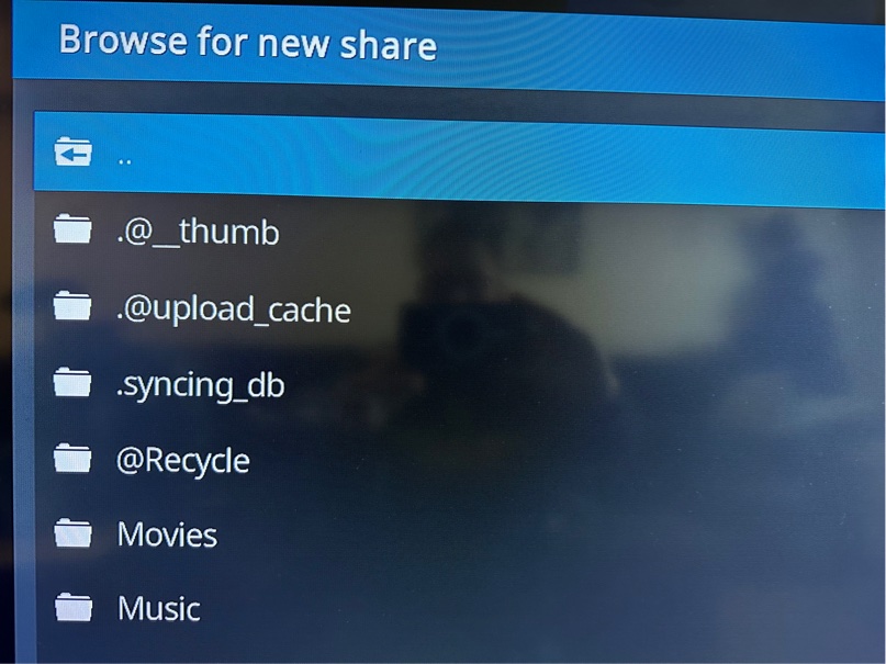

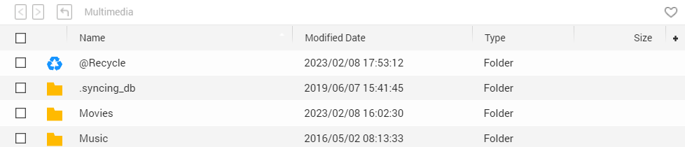

    I think it is coming from this .@__thumb folder as seen on the file manager picture of my NAS, but when I actually look on the actual NAS, that folder doesn't exist. I even have show hidden folders selected on my NAS.
    I think I can solve this somehow by getting rid of that folder, but I can't seem to find it.
    If you look at my NAS screenshot, you can see there is no .@__thumb folder. But if you look at the screenshot of the file manager picture, it's there.

  • Yep, QNAP TS-212 NAS. I'll try and search again. I tried searching .@__thumbs a few times and came up with nothing, but I'll try some variations. It's driving me nuts. I have like 90 files in one TV section. At one point it was creating a thumbnail for every movie but was just creating this so called "tom thumb" thumbnail in my movies section and I had no idea what the files were until manually deleting them. And they had the same file layout as above.
    Looked like this...

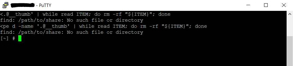

  • Thanks for the code. I happened to come across that code in a qnap forum, but I have never used Putty or SSH, so I am trying to figure out how to do that first and if I am typing the above exactly or what. I tried another option of trying to find it through Total Commander as someone else said they were able to do, but no luck. I have disabled the appropriate stuff in Qfinder, so no new stuff is generated, but getting rid of the current stuff is my issue. I am a newbie with SSH.
    One thing I don't understand is I have never had this issue until about a week ago, so I have no idea what caused it to just start happening.
    I did try the code above as seen in the following Putty. I've SSH'd into my NAS then copied the code. I have no idea if it took or not because again I'm new to SSH and am not sure what tells me if the command worked or didn't work. It does say no such file or directory, but I did read that may be normal and perfectly fine.

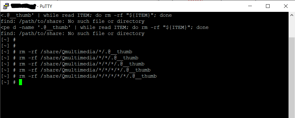

    I also tried this command I found as well.
    rm -rf /share/Qmultimedia/*/.@__thumb
    rm -rf /share/Qmultimedia/*/*/.@__thumb
    rm -rf /share/Qmultimedia/*/*/*/.@__thumb
    rm -rf /share/Qmultimedia/*/*/*/*/.@__thumb
    rm -rf /share/Qmultimedia/*/*/*/*/*/.@__thumb
    Again, pasted it into Putty, hit enter and again no idea if it took or not as it doesn't say anything.
    I do still see the @__thumb folder under file manager in Kodi, so both commands probably didn't work.

  • You need to replace /path/to/share with the path to your media share or maybe even just / (the root of the filesystem) and then it will crawl the entire box. The find command will run recurrsively so it's the easier one to use.
