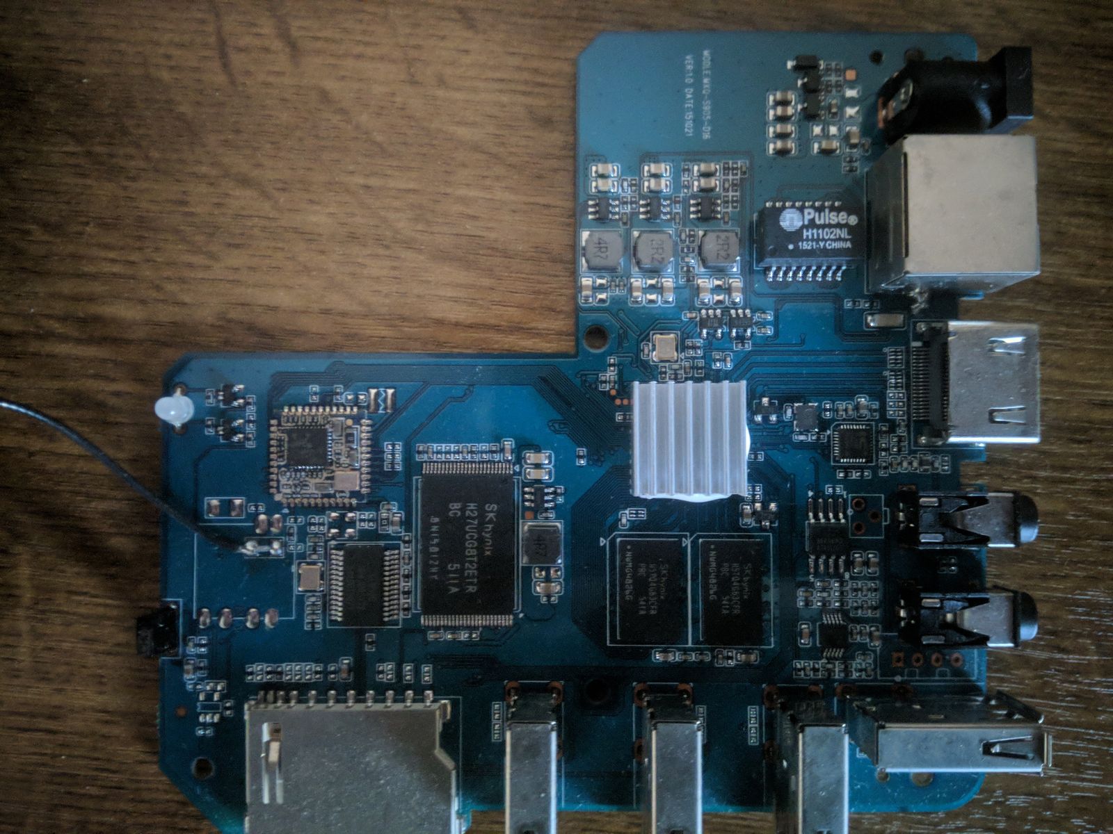

  • I just got the tvbox back, so there you go.
    https://imgur.com/a/O5TdEEc
    The neighbor literally destroyed all 4 feet instead of opening small holes on them. Now the tvbox has no feet at all :(

  • The neighbor literally destroyed all 4 feet instead of opening small holes on them. Now the tvbox has no feet at all :(
    I think he had to do that to search for hidden screws. Feet are easy to replace (hardware store), compared to a case.
    Let's wait for chewitt now. Thanks for the pic.
  • The wireless module is top-left on the PCB (below the cut-out). I can't see the model markings on the chip, but the Realtek "Crab" is visible and that explains the lack of WiFi probing on the device. It's an older Realtek chip not supported in the upstream kernel (because if it was, it would probe) and LE does not add Realtek vendor drivers as they're a pain in the rear to maintain over time. They do exist though, and you could always self-build an image with the driver embedded. The BT side of the module is serial (not SDIO) and in some cases there is support for the BT part but not WiFi (as they are different drivers) but for that we need to know the specific chip model as the "compatible" string in device-tree determines which driver and how it loads. The photo isn't high-enough resolution to see the model details, and they're often a bit fuzzy to start with.

  • Do you mean the one right next to the hdmi port, labeled as "av"? As you can see on my photo above, there SHOULD be a button over there but it is missing. It just has 3 tiny holes there. And that is the root of all my issues with it.
    Moreover, the fist thing I noticed on xda's photo was that small "bump" that is inside the spdif port, but my hopes were wiped when I saw the board on my tvbox.
