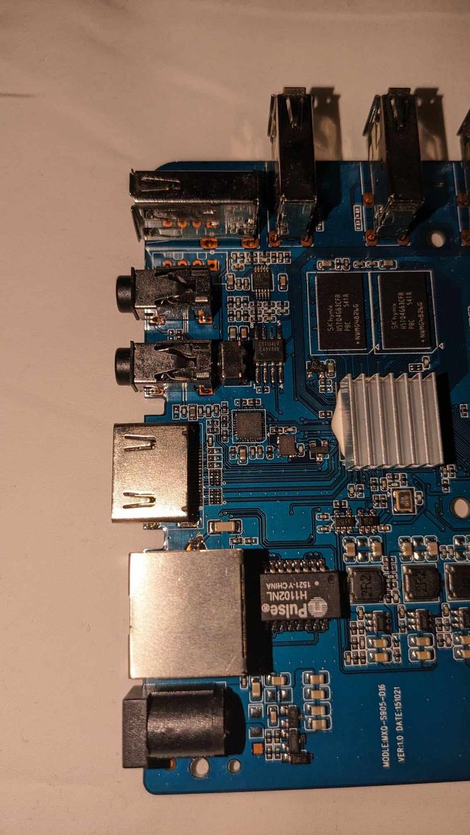

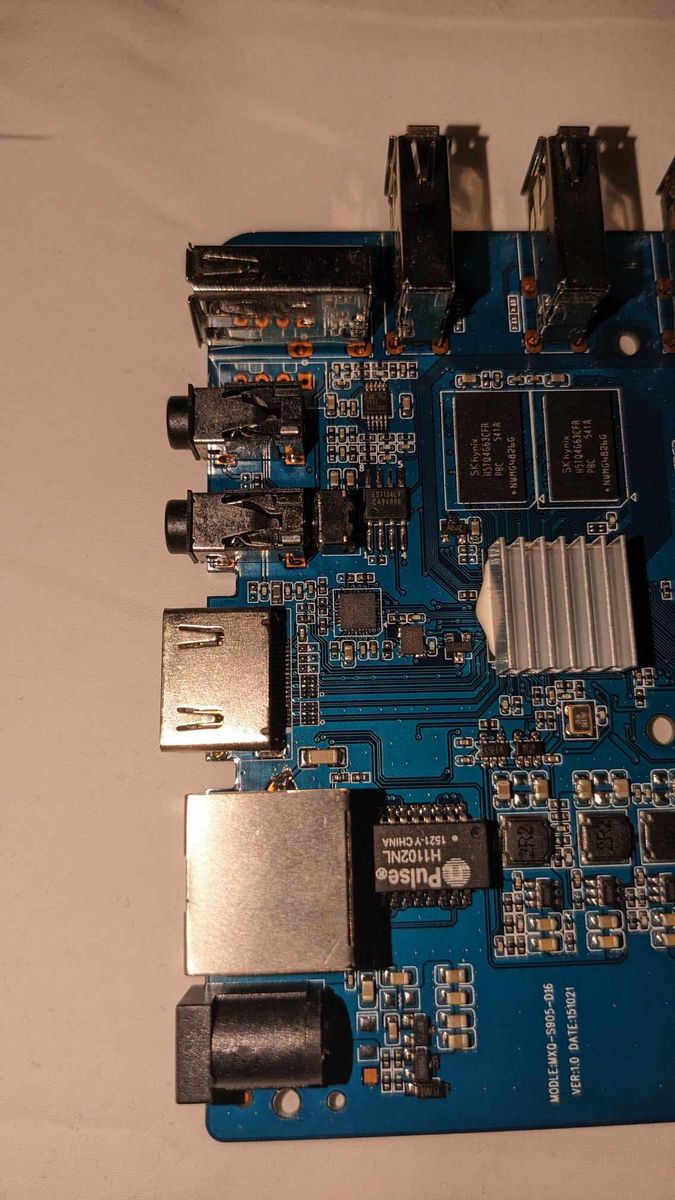

  • You are right, I did not mention the most important thing! So, it's an mxq pro 4k, with s905, 1gb or ram, 100Mbps ethernet... and no idea about the wireless.
    And from all the dtb files in there, the ones that are generic and start with meson-gxbb-* are meson-gxbb-p200 and meson-gxbb-p201.
    Here is pastekodi with all the info.
    http://ix.io/4njx
