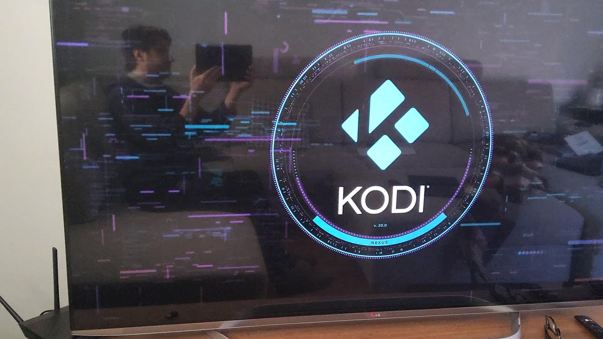

    When i start the box with "6 sec button method" than the Libreelec started to boot and the partitioning went well. After the restart i see the Libreelec logo for ca 20sec. After the Libreelec logo disappeared i see only a black screen, or the Kodi "load" screen.(I have not seen any screen like "Starting kodi the first time"). I restarted the device sometimes and always ended up with black screen or kodi load screen.
    To be sure that i did everything well i re-flashed the SD again, made the uEnv.ini changes and started to boot again.
    I left the box for 2 hours, and i still see the kodi loading screen so i guess it is frozen.

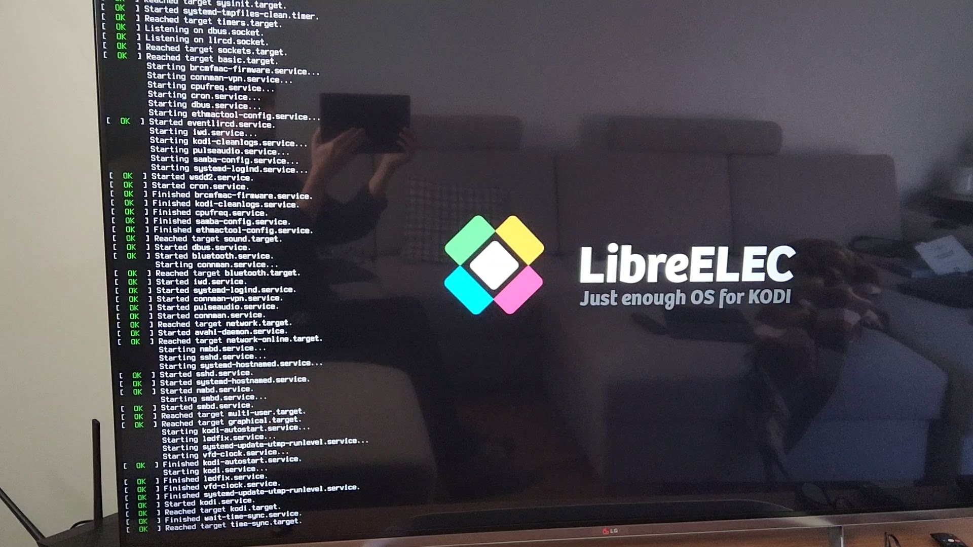

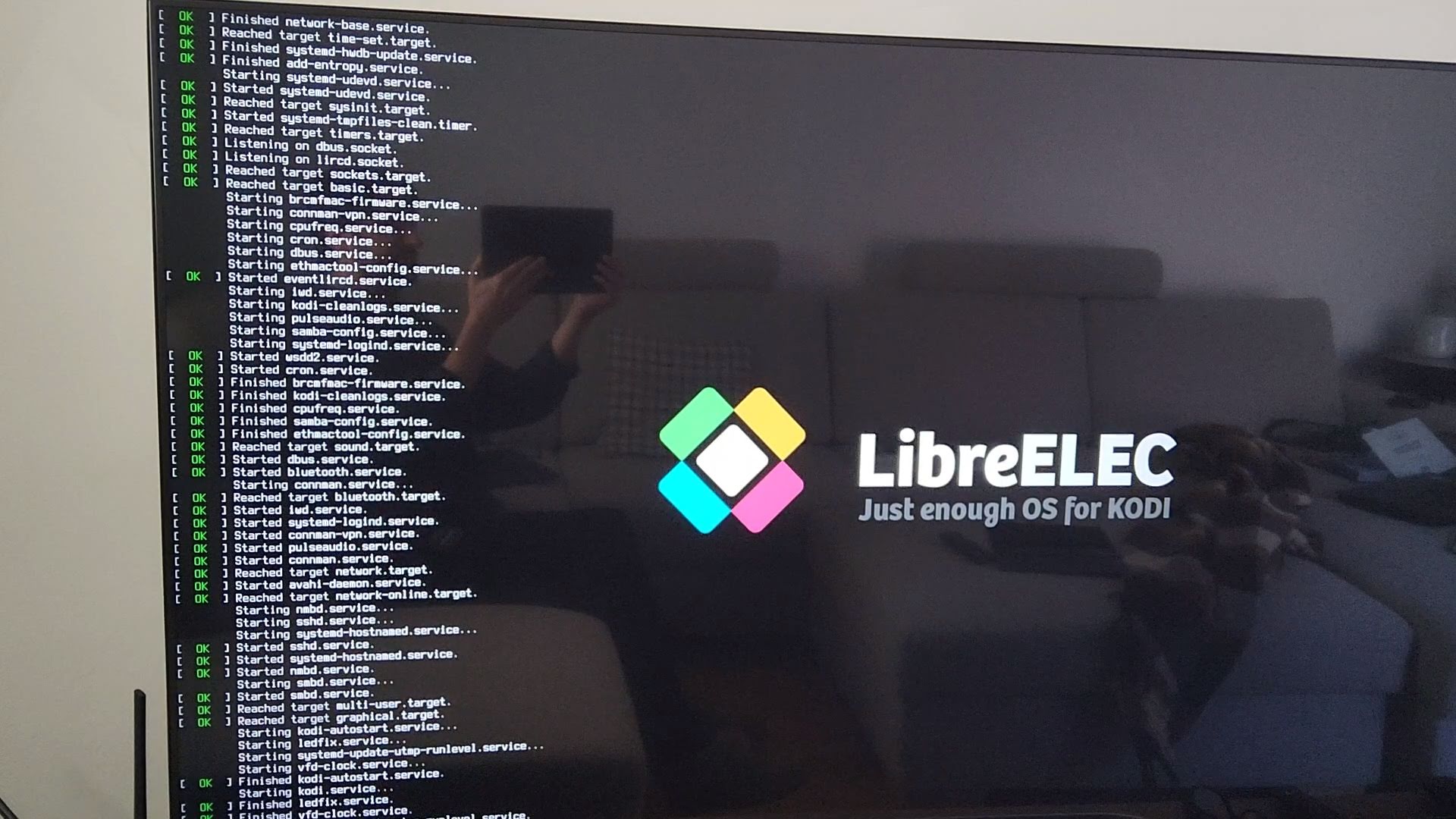

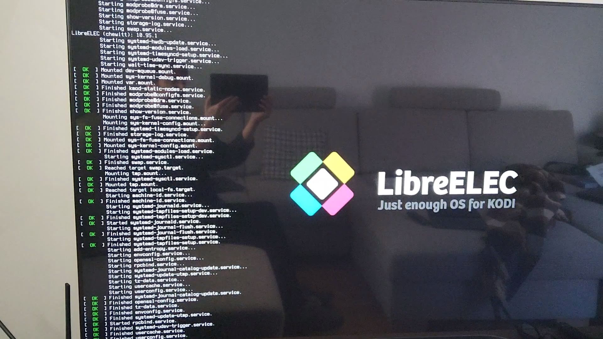

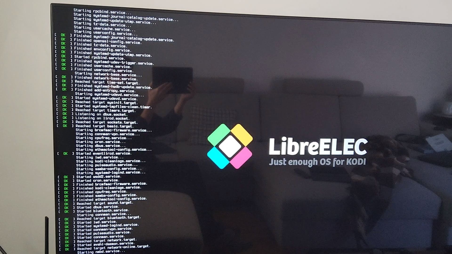

    When I removed "quiet" as well from the parameters, and left only ssh as additional parameter than i seen no error on the boot messages before the kodi load schreen appear. Only [ok], and some lines without any signal(as you see on the attachment).
    I have a video about the boot as well if you need it :)
  • If you boot to Kodi (and let it hang for a bit) then boot again to textmode and "cat /storage/.kodi/temp/kodi.old.log | paste" and share the URL that's generated, this will pastebin the previous Kodi log and might give some hint on why Kodi is failing to start. If the log doesn't exist there might be a kodi.log file in the same dir. I don't see anything in the screenshots so I doubt the video will be useful.
