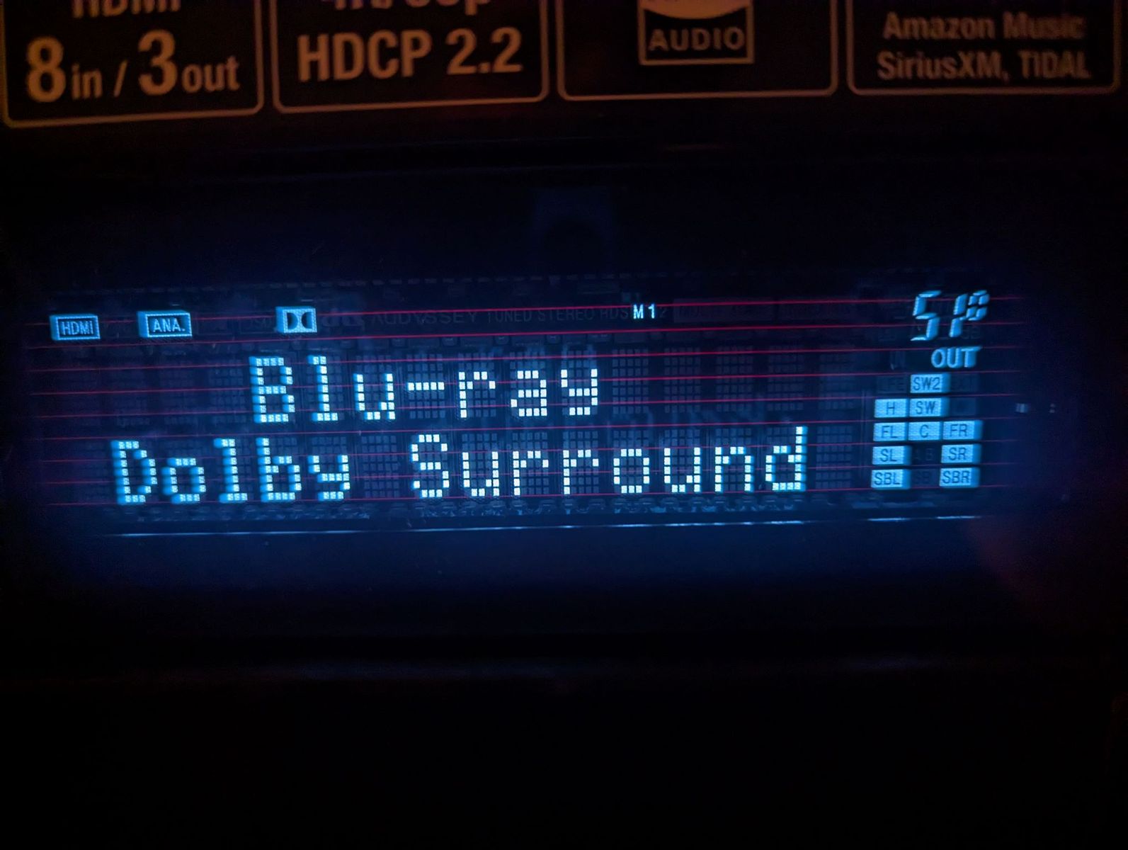

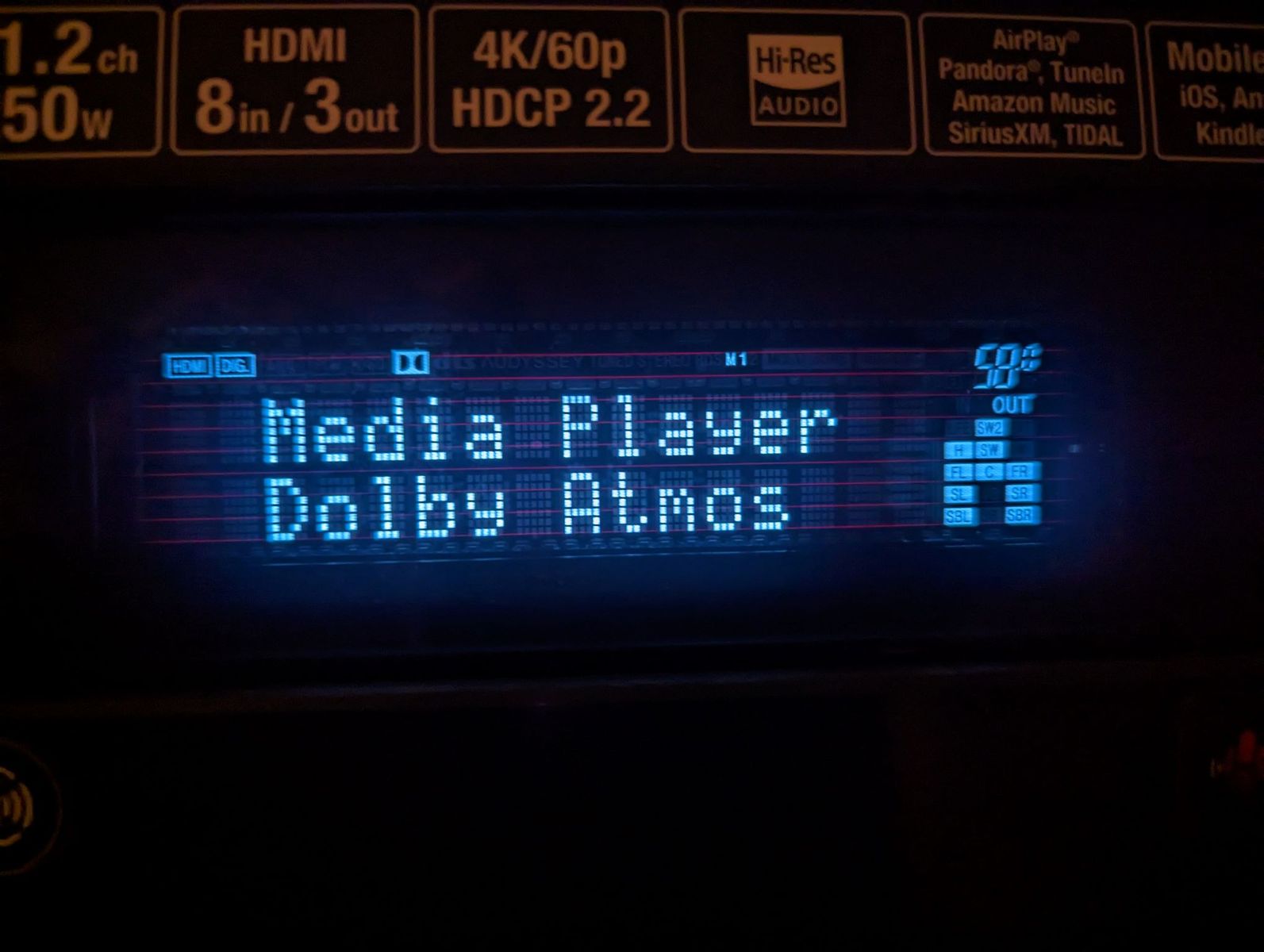

  • My Minix Neo U9-H is now running LibreELEC-AMLGX.arm-10.95.0-box.img very well off of an ultra fast Micro SD card. So far, I've only encountered one significant issue. It fails to play any HD audio streams and that is a real deal breaker for me. The Minix box still has the old copy of LibreELEC 8.2.2.3/Kodi 17.6 running from the onboard eMMC so by inserting and removing the SD card with the LibreELEC 10.95.0/Kodi 20, I am able to switch between the 2 versions and do apple to apple comparisons to confirm the issue is not with the hardware or the specific movie file...same physical hardware (Minix Neo U9-H Player -> Denon AVR-X6300H Receiver) playing same mkv file (Alita Battle Angel 4K HDR10 Dolby ATMOS). When running LibreELEC 8.2.2.3/Kodi 17.6 off of the internal eMMC, all formats of lossless audio are handled correctly - Dolby TrueHD, Dolby TrueHD with Dolby ATMOS, DTS-HD Master, and DTS:X (see Old Libreelec image attached). When running the new LibreELEC 10.95.0/Kodi 20 software on the same Minix box, I get no HD audio of any type. The same audio file (in this case it is Dolby TrueHD with Dolby ATMOS) will not play. I have to switch to the Dolby Digital (AC-3) lossy 5.1 audio file to get any sound. This can be seen in the other attached image New Libreelec (small).jpg. All audio settings are the same in the 2 Kodi versions, including allowing Passthrough of all listed types of audio codes. I've tried numerous movie files with HD audio and had the same results. My newer Zidoo Z9X media player with OSMC and connected via HDMI to same Denon receiver also handles all of the HD audio formats with no problem. Anyone have any ideas?
    NOTE: The New Libreelec image shows Blu-Ray as the source but that's only because I switched inputs on the Denon to rule out an issue with the connection and forgot to switch back before taking the photo. The source is the same in both photos, the Minix.
  • Can you please share Kodi debug log from the box. Reboot (to clear logs) then play something with HBR audio, and run "pastekodi" from SSH and share the URL. I'd like to see some infos from the log. Thanks.
    Here you go.
    http://ix.io/4n6D
    Not sure if it is relevant, but I compared the debug log from the Minix U9-H running LibreELEC 10.95.0/Kodi 20 (the URL attached above) which doesn't pass through HD audio of any type and the debug log from the same Minix box running LibreELEC 8.2.2.3/Kodi 17.6 (which passes all HD audio formats correctly). One thing that jumped out at me right away was that the Enumerated ALSA Devices in the working old system are identified as AML-M8AUDIO. In the LibreELEC 10.95.0/Kodi 20 where the HD audio passthrough doesn't work, the Enumerated ALSA Devices are identified as P230-Q200. Not sure if this is a harmless renaming of the audio device over time or if it is actually misidentifying the audio device in a way that messes things up.

  • There is no driver code in-common between the Legacy image and AMLGX image so there is no value in making comparisons. It's like pointing at a Nissan car and a Ford car and saying .. "they're different" .. because they are.
    I'll add the investigation to my list, but these days Amlogic support is largely a one-man team (and I don't write driver code) so these things take time.
