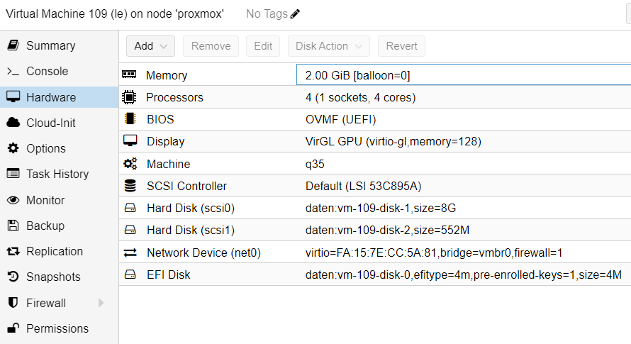

  • Hello thanks for your replies. I was able to run LibreELEC without a dedicated gpu by setting the display setting in proxmox to "VirGL". it's a quite new feature that was introduced in proxmox 7.2. VirGl provides the needed OpenGL functionality. I'm very happy that is works now.
    Keep up the good work and a happy new year!!
  • Hello CvH you need to follow the instructions from the tails tutorial i mentioned in post number 5
    The import disk to vm part is not that difficult but I have no luck in running it.
    As soon I switch to uefi/q35 I am not able at all to boot from the LE.img anymore. If I run it with your settings I end up at the efi loader.

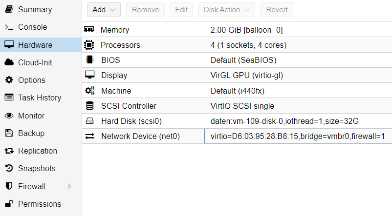

    Running it with i440fx/pc35 and SeaBios I can even install LE, but it does not run past the LE bootscreen.
  • best thing would be to delete the existing vm and completely start from scratch and follow the tutorial from post number 5 step by step. this should work
