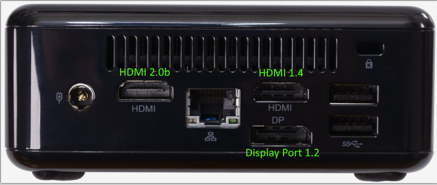

    The HDMI connection sequence is: Beebox-AVR-eARC-TV and also tested Beebox-TV-eARC-AVR.
    I had the Beebox connected to the TV (Samsung) and then to the AVR, on HDMI port 2.0.
    I have three drivers to choose from: 1st DP port DEV=0; 2nd HDMI DEV=1; 3rd HDMI DEV=2.
    The drivers 2nd HDMI DEV=1 and 3rd HDMI DEV=2. have no audio.
    Although I have connected the AVR to HDMI port 2.0b I should select 1st DP port DEV=0, really?

    OK, the HD audio is played with the DP... Samsung... driver.
    Because of the name of the driver, I would never have selected this driver, because the player is connected to HDMI 2.0 port and not to Display port.

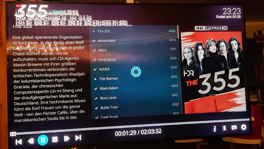

    Unfortunately, no 4k movie is displayed. The player just shows a rotating circle and the HD audio plays correctly.
    What could be the cause of this?

  • ^ According to this, there are two streams: #0 which is 4K, and #1 which is 1080p. The next lines are confusing as they appear to show stream 0 being discarded (as it contains Dolby Vision) and then the last line shows it opening stream 0. Regardless, the root issue here is no support for Dolby Vision. This is a known restriction; there is no open-source implementation for Dolby Vision. Kodi can play DV media on Android devices that have DV licensed support built-in to their software, and on a small number of Linux devices that use (Android oriented) ARM vendor kernel/ffmpeg sources have have DV support. Nothing exists for Intel so there is no playable video stream; hence what you see.

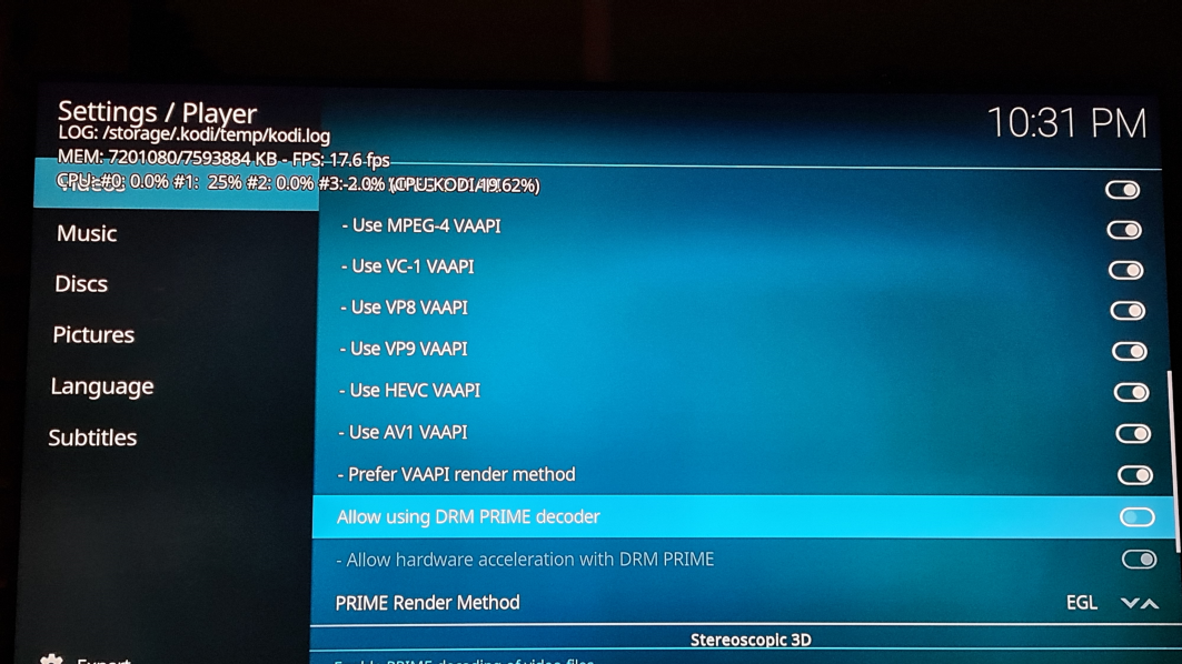

  • Hi chewitt
    The problem with the 4K movies was caused by a setting in Kodi Player.
    I had enabled the Setting / Player / Videos / Allow using DRM Prime decoder.
    Deactivated this setting again and voilà - also the 4K movies are displayed.
