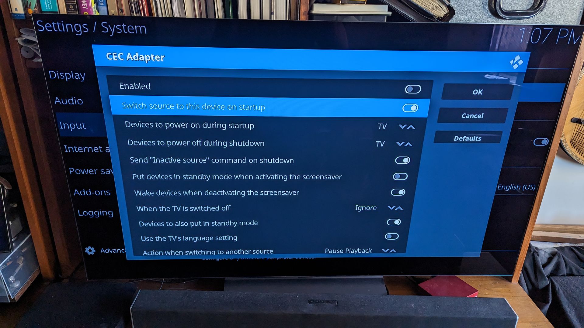

If you're using the Slice remote, turn CEC off in Kodi settings (CEC is what will be waking the TV)
It's in system settings, input then peripherals. You should see a CEC adapter, go in and disable it.
Check the Kodi's Settings - System - Input - Peripherals menu. You should see the CEC Adapter there.
found and shut off thanks
