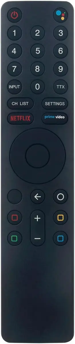

  • Great!
    In case anyone needs to know, this is the remote control:
    chewitt
    I also tried to map the other buttons to Action IDs.
    The keystroke for the buttons INPUT and TTX are KEY_RECORD and KEY_FIND.
    I added
    <lircmap>
     <remote device="devinput">
       <language>KEY_RECORD</language>
       <subtitle>KEY_FIND</subtitle>
     </remote>
    </lircmap>
    to .kodi/userdata/Lircmap.xml
    and
         <language>AudioNextLanguage</subtitle>
         <subtitle>NextSubtitle</subtitle>
    to .kodi/userdata/keymaps/remote.xml
    Kodi.log for button INPUT:
    2025-12-27 17:20:31.791 T:3410    debug <general>: Keyboard: scancode: 0xc2,
    sym: 0x00 (), unicode: 0x00, modifier: 0x0
    2025-12-27 17:20:31.791 T:3410    debug <general>: GetActionCode: Trying Hard
    y keycode for 0xf200
    2025-12-27 17:20:31.791 T:3410     info <general>: Skipped 3 duplicate messag
    es..
    2025-12-27 17:20:31.791 T:3410    debug <general>: HandleKey: 0 (0xf200, obc-
    61697) pressed, window 12901, action is
    2025-12-27 17:20:31.891 T:3410    debug <general>: Keyboard: scancode: 0xc2,
    and for button TTX:
    2025-12-27 17:21:30.353 T:3415    debug <general>: CLibInputKeyboard::Process
    Key - using delay: 400ms repeat: 80ms
    2025-12-27 17:21:30.354 T:3509    debug <general>: Thread Timer start, auto d
    elete: false
    2025-12-27 17:21:30.358 T:3410    debug <general>: Keyboard: scancode: 0x88,
    2025-12-27 17:21:30.358 T:3410    debug <general>: GetActionCode: Trying Hard
    2025-12-27 17:21:30.358 T:3410     info <general>: Skipped 3 duplicate messag
    es..
    2025-12-27 17:21:30.358 T:3410    debug <general>: HandleKey: 0 (0xf200, obc-
    2025-12-27 17:21:30.493 T:3509    debug <general>: Thread Timer 1401754872603
    52 terminating
    2025-12-27 17:21:30.508 T:3410    debug <general>: Keyboard: scancode: 0x88,
    The keyboard scancode is different for the buttons, but Kodi maps them to the same key 0xf200, obc-61697.
    This is the same with other buttons on the remote. ChatGPT sais, this is a limitation in Kodi. Is this correct, or is there a way I can get running different actions for the buttons?
    Edited once, last by orclex: Merged a post created by orclex into this post. (December 27, 2025 at 4:28 PM).
