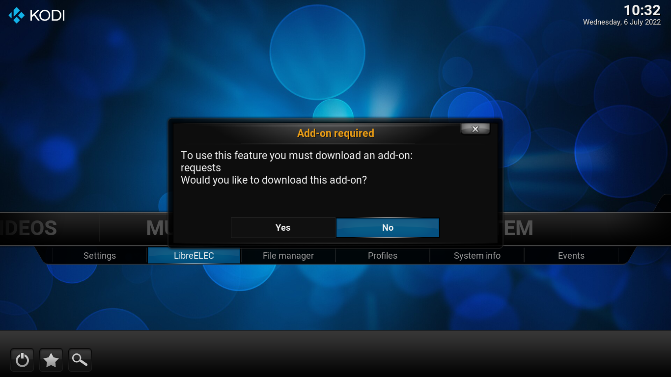

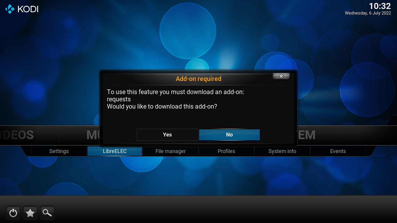

    kodi-send --action="InstallAddon(script.module.requests)"
    the following will appear on the Kodi screen and you must confirm installation there.
