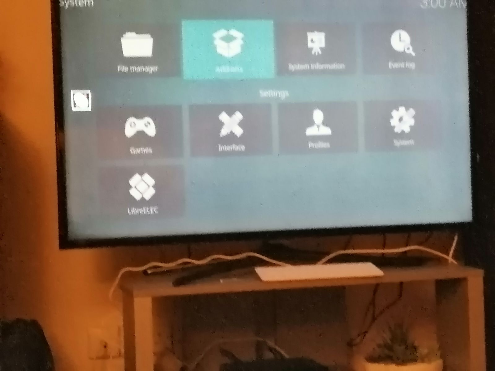

    Thank you for getting back to me
    I am in Expert mode already.
    Under System i have the following choices;
    file manager, add ons, system information event log
    games interface, profile, system, libreElec

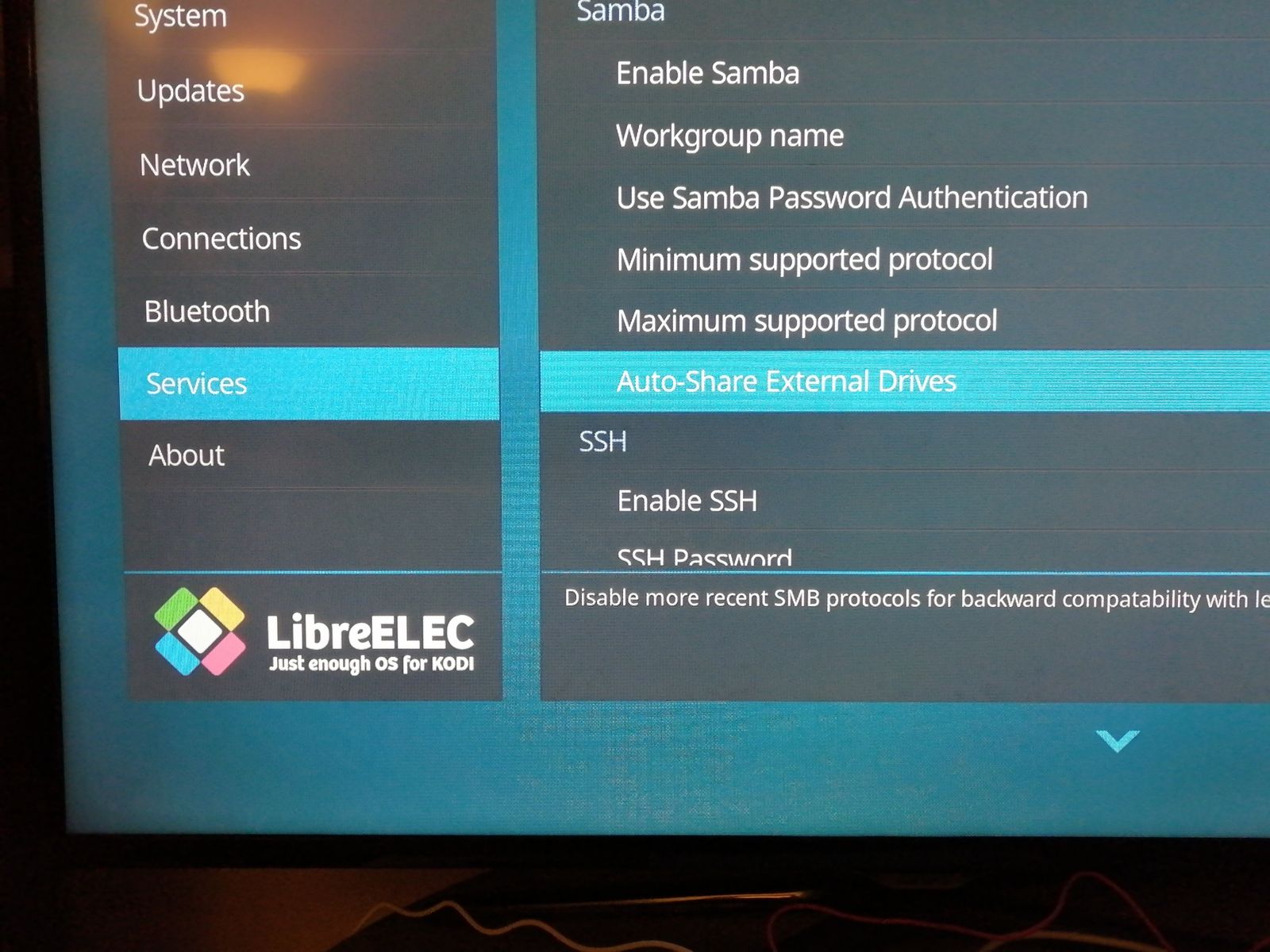

  • You are one level ABOVE any menu that shows the "settings level" on the bottom left corner. Click e.g. on system and you will find it.

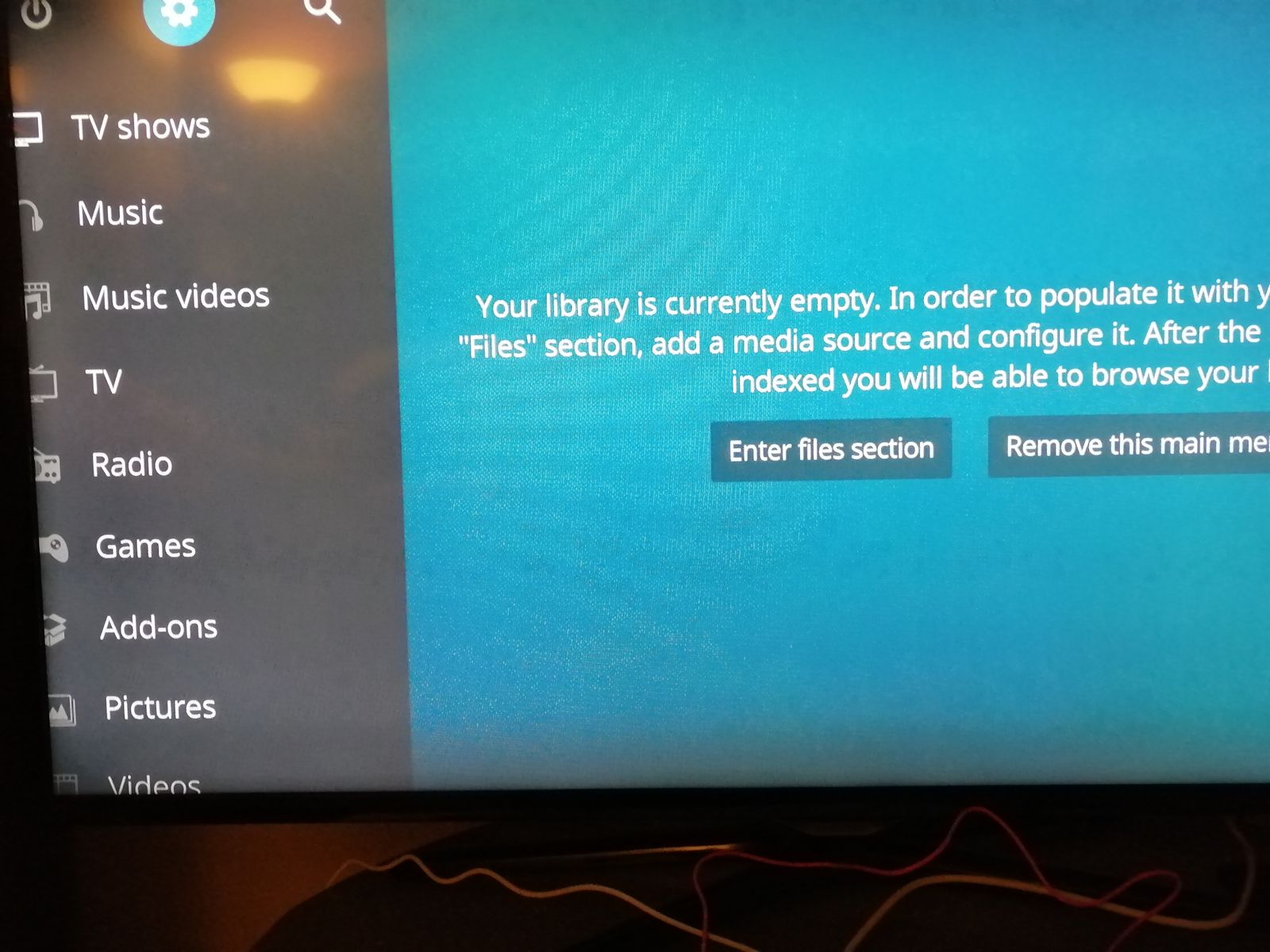

    I have looked everywhere .. 1st i click settings and then go to services option. However i tried all other panels and options too in Expert mode
  • This is libreelec settings, it has nothing to do with kodi settings. Choose another submenu from the settings, e.g. interface, or wait for someone that uses the estuary skin to guide you further.
    I do not use it because I absolutely hate tile-styled interfaces, so I can't help you more.
  • excuse the thumbnails i was trying to delete the picture instead of repeating the thumbnail 3 times

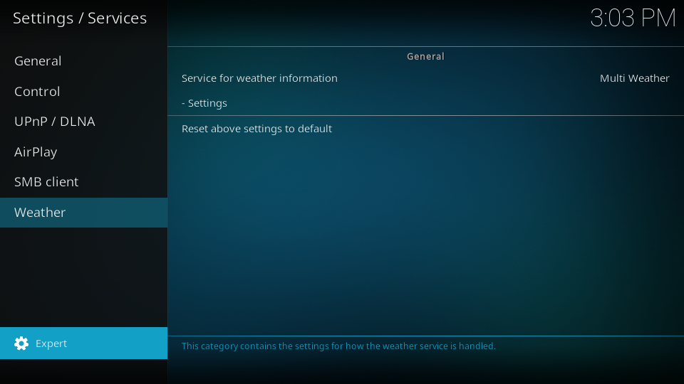

  • Go through Kodi menu Settings (Wheel) - Services - Control - Allow remote control via HTTP slider
    Its not there. However i found it in the end and i thought i would share as it may save time for someone else
    Running 10.0,2 It is not where the Kore support says it is .
    Instead look under
    Weather option (Expert Mode)
    Once that is clicked you will see the following options
    General
    Control
    UPnP/DNLA
    AirPlay
    SMB Client
    Weather
    Select Control and enable Allow remote access via HTTP

  • Thanks a lot JP. Using Coreelec but same process going through Interface> Skin> Configure skin...> General> Show weather info in top bar with a slider but when clicked on it opens the Settings/Services that now includes Control
    Freaking weird! Not included previously under System or Coreelec settings.
    No way in the world I would have found it without your clues!
