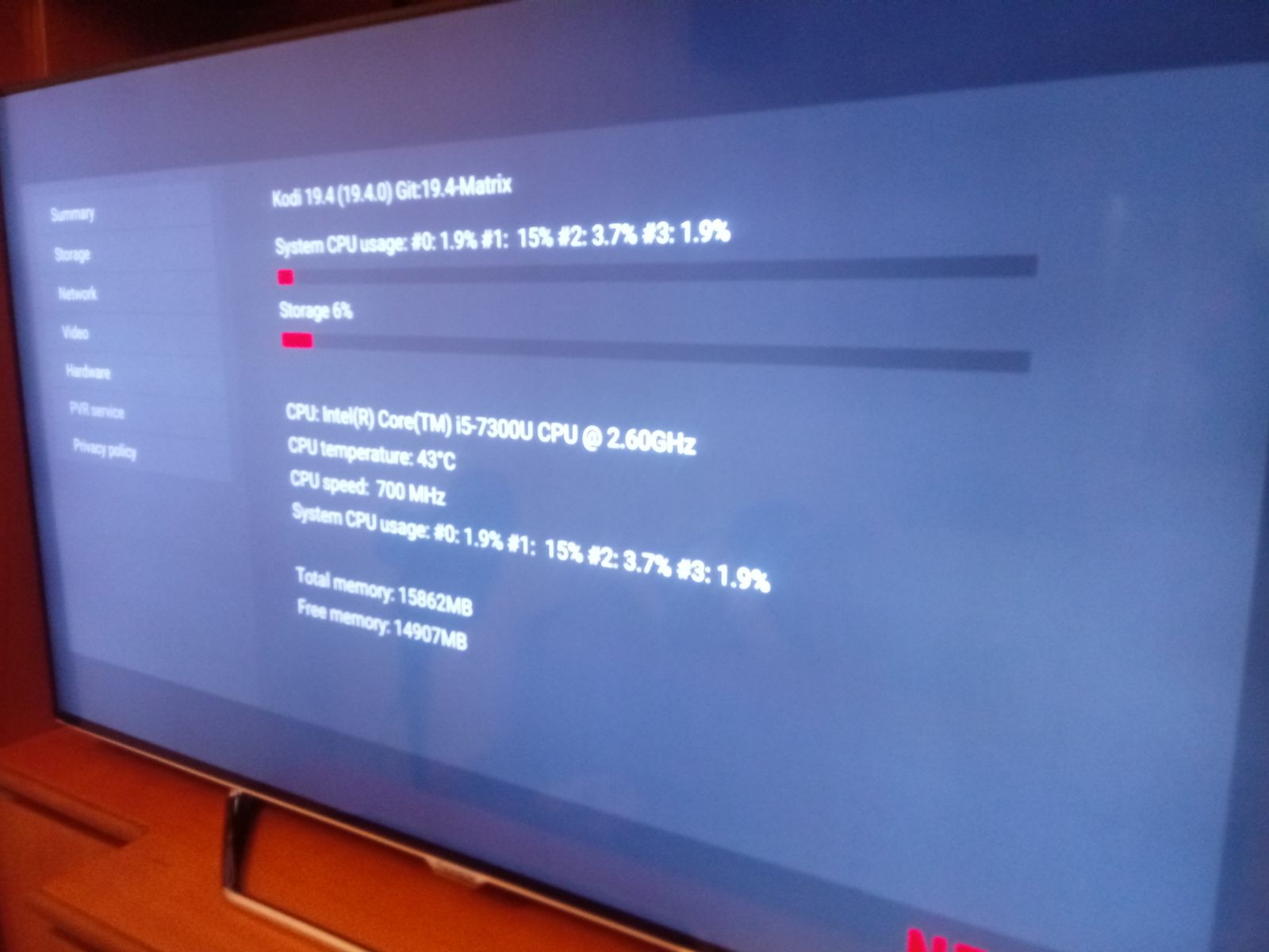

    I upgraded my old HTPC so i can finally watch 4K videos. The specs are:
    Intel Core i5-7300U Processor
    Intel HD Graphics 620
    16GB RAM
    265 GB for Libreelec
    6TB for Movies
    ELSKY QM9700/QM9600-6C Motherboard

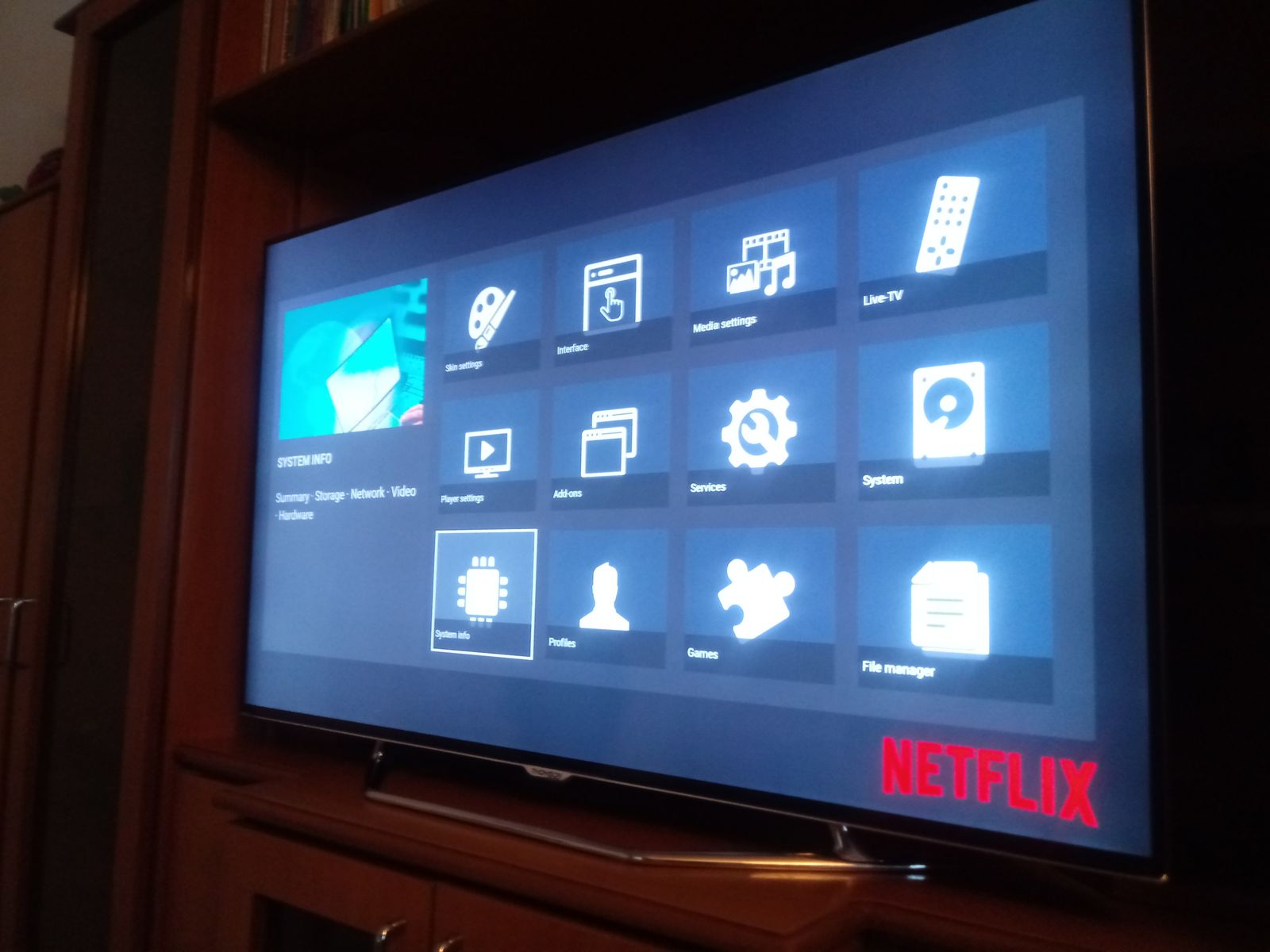

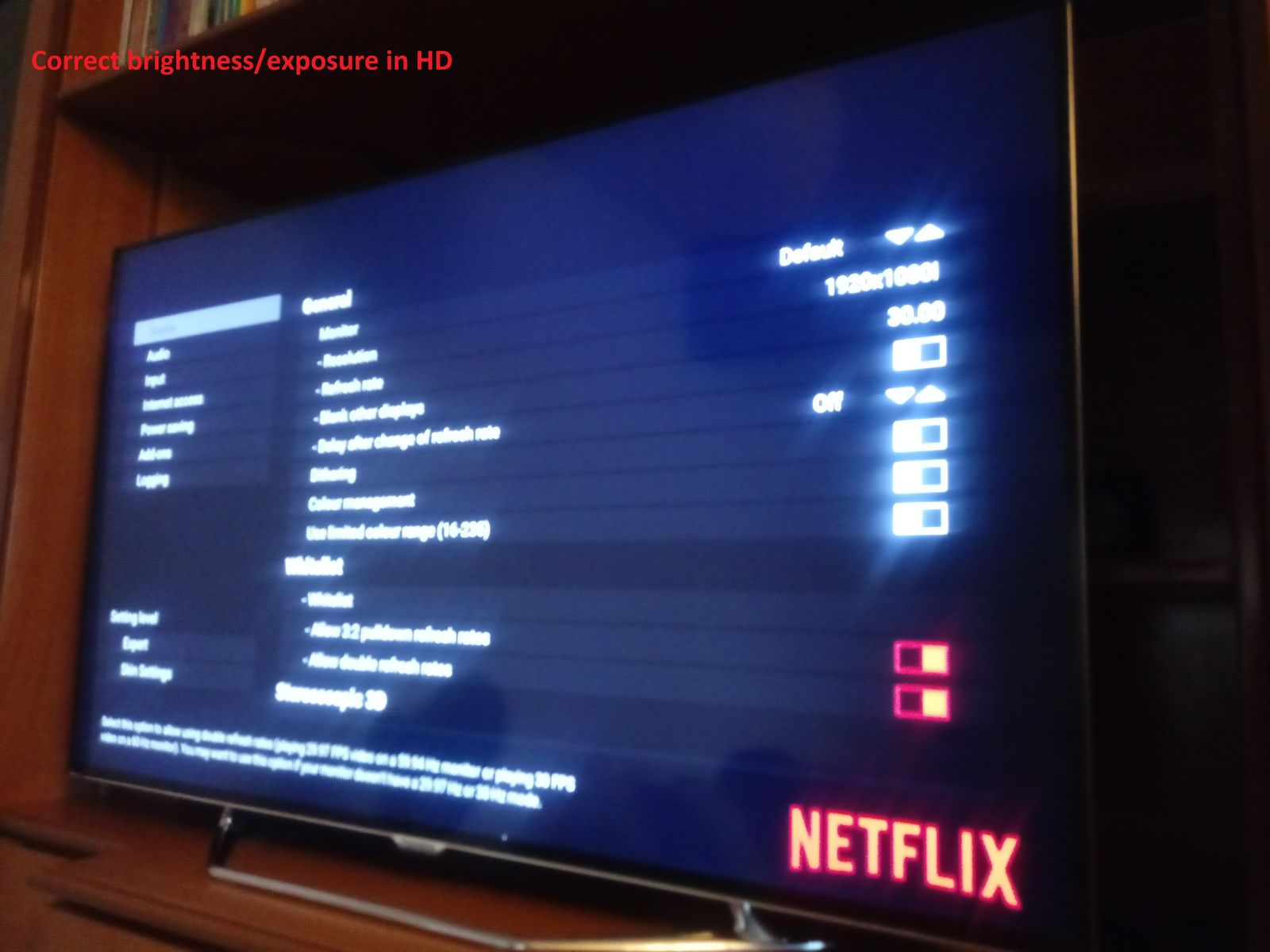

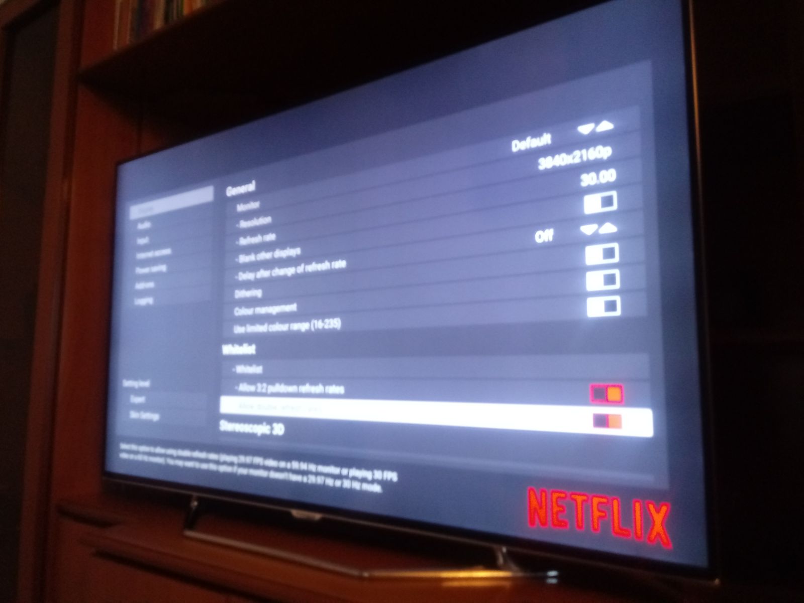

    Everything is fine up to 1080p when I switch to 4K resolution colors are totally washed out and everything is over exposed with an excessive amount of brightness. This can not be fixed by changing settings from the TV.
    Also when this happens I lose some settings from the TV, Saturation, Noise reduction, Back stretch and other settings disappear from the TV menu or are grayed out.
    Anybody know what is happening ? Am I losing color space for some weird reason ? is this due to the cable not having enough bandwidth ?
    To circumvent the problem I made a 2K custom resolution and the problem is not that evident there and can be fixed by settings on the TV.
    The problem is present in Kodi menus and Movies. Any ideas ?

    HOWEVER - beware the Kodi setting for 16-235 Limited output - that is for a very specific, and increasingly less useful, use case ISTR. I haven't used x86 LibreElec since the days of Chromeboxes, so am not sure what the x86 GPU Limited/Full range driver situation is.
    its not just limited color range black is super light grey. Everything is over exposed including the kodi menus. You can watch anything like that
    Is that you enabling Limited Colour Range in the Kodi system setting menus? If so that's for a very specific use case - it doesn't enable the Limited output range in your GPU driver settings, it is there to solve a problem in older systems. In many cases this will output a nasty 'double limited range' these days (it was there to bypass video cards/drivers that would only output Full range when people had Limited range displays, and before InfoFrames flagging Limited vs Full were in widespread use).
