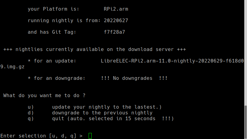

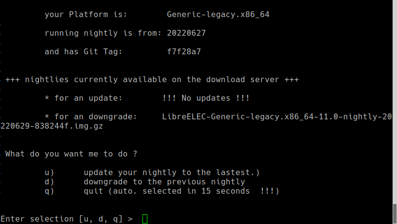

    anyway, a new release of the script what now supports: Generic, RPi2, RPi4
    alas I only could test for Generic and also downloading the RPi*, but for those NOT the compare part (last nightly already on the box)
    could you please test ?
    you could also start the script with sh -vx ./get_nightly.sh

    an hour ago I was thinking to extend the script with more hardware types and I discovered that I dynamically could read the info's I need from /etc/issue and kodi.log ... (me idiot :/ )
    but as of now it could update Generic and I hope others can do RPi* too (couldn't test; no HW here)
