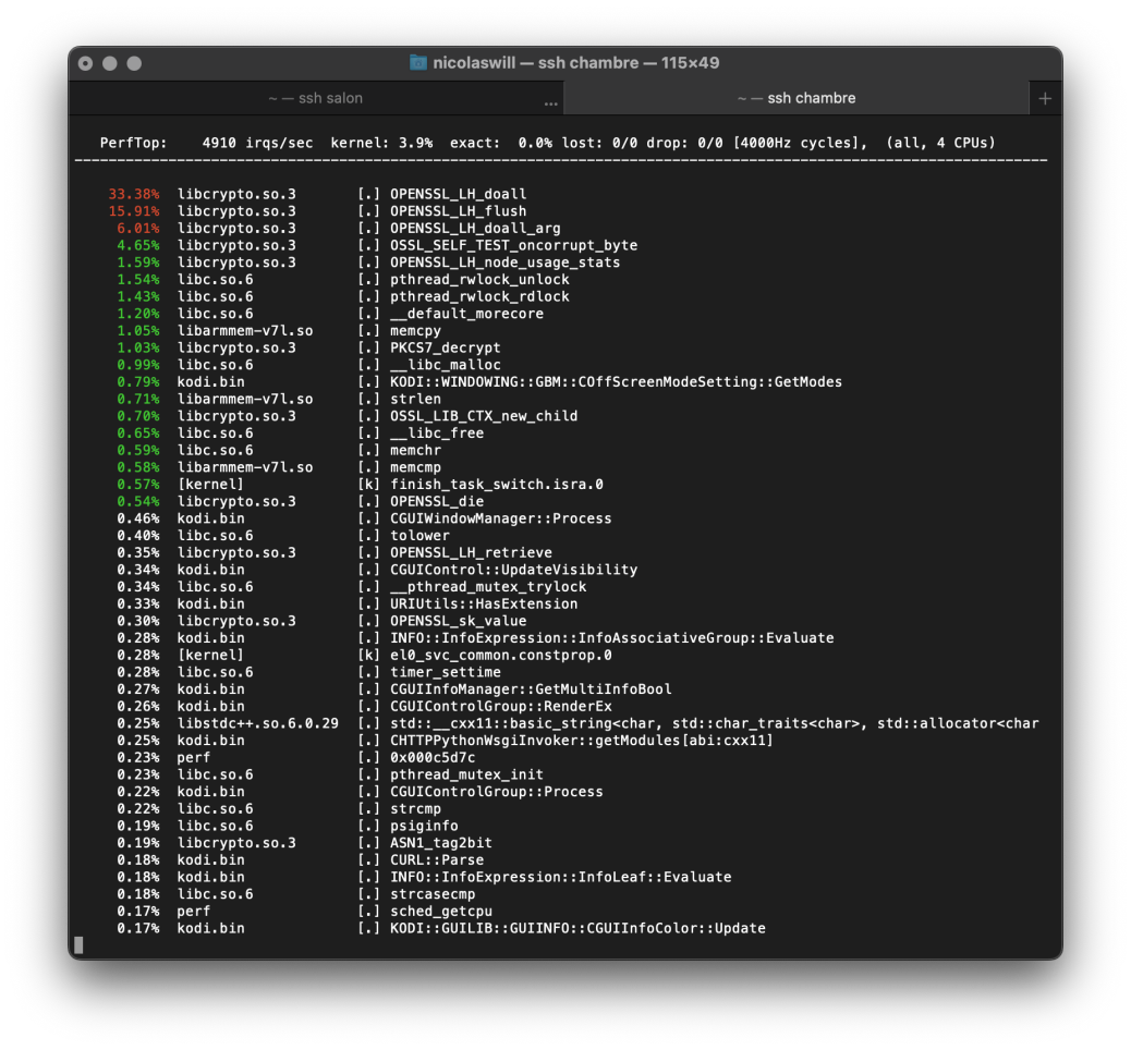

  • Run "perf top" when it's laggy. Leave for a minute to settle.
    If you see "vc4_atomic_commit_tail"/"clk_request_start" appearing in list (and increasing in percentage), then you have the same issue.
    I don't think LE has updated Pi kernel too recently, so you'll have to wait for that to happen, and then you can test a nightly.
    Noted, I will report back.
    Thanks!

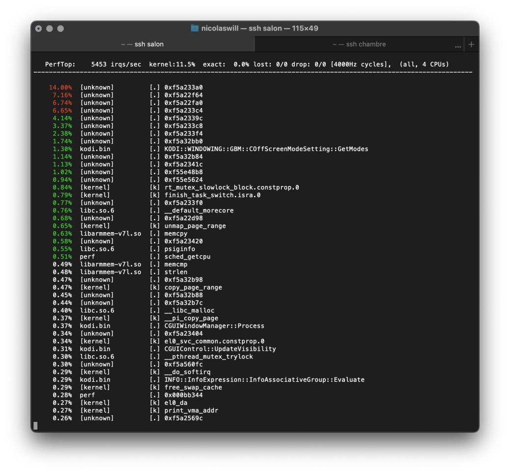

  • One doesn't seem to be getting symbols for functions, so hard to say what's happening.
    The other shows openssl is repsonsible. That will be user code (not kernel) so is isn't the issue I was referring to.
    Is that the on with the watchdog addon?
    In either case I'd be tempted to (temporarily) disable that addon (and potentially others) to try to narrow it down.
    I'll explore which as what addons. But no, the machine with OpenSSL doing strange things doesn't have the watchdog.
