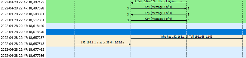

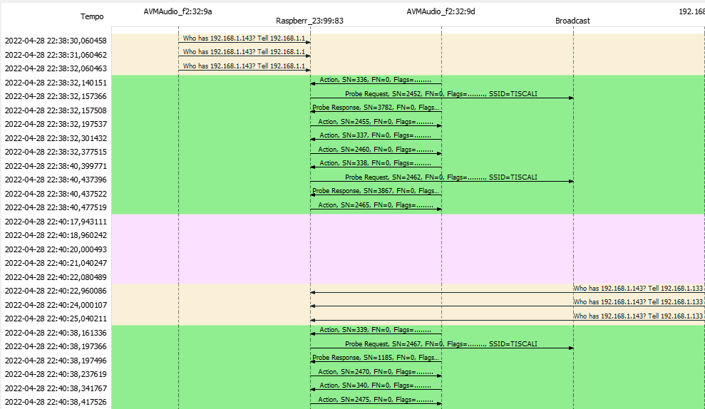

  • I have taken some pcaps from my router, to see what's going on.
    What I see is that, all of a sudden, while the WiFi is still active, 802.11 packets between the router and the rpi4 are sent and received and the IP address is maintained (so, apparently, it's all good), nobody can get an ARP answer from the rpi4. The router tries, the other raspberry tries, with no success.
    It all starts at 22:38, when the capture begins and I try to connect to my NFS server. At 22:41 the vpn service detects something is wrong and connmand tears down the routes, but the WiFi gets disconnected only at 22:47. As soon as it reconnects, ARP tables are correctly populated and everything is back to normal.
    Here you see the router sending an ARP request to the RPI4, getting no answer. Also the other Raspberry tries, with no luck
    Wifi gets disconnected at 22:47 and the rpi4 reconnects, ARP is populated
    At this point in time, the NAS (.120) is also discovered and I can start watching the TV program (10 minutes after my initial atrempt)
    So it looks like the WiFi is up but ARP requests fail, how can it be? And how could I write a script that manually tears WiFi down and up if I see something like that?
