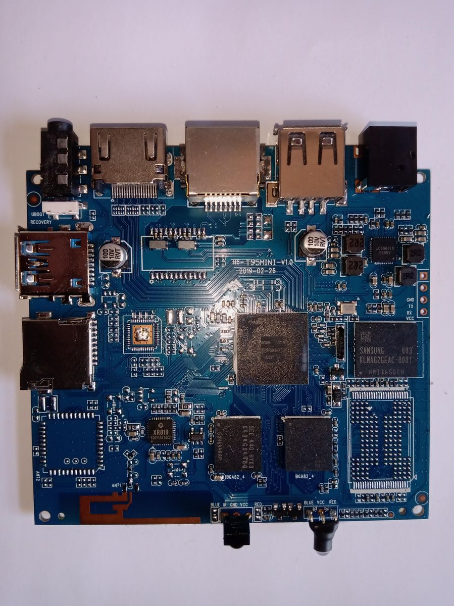

  • mod81 can you post clear photo of T95 PCB? One developer noticed that some boards need to have AVCC power enabled for thermal sensor to work correctly.
    As requested here are photos of both sides of the PCB from my T95.
    FYI I know there is no heat sink fitted on the H6 CPU on the picture, but that isn't the cause of the overheating. As it was overheating in LibreElec and Armbian before I removed the stock heat sink to fit a bigger one from a SSD cooler to see if that would make any difference to the CPU temps. But I had to take the SSD cooler off to take the pics of the PCB. (The SSD cooler did not resolve the overheating issues on LibreElec but did make it take a few minutes longer before it shutdown)

  • Ok, so this board has fixed voltage regulators, so there is probably no issues with them. Probably thermal driver has some bug, but that is outside of my expertise.
